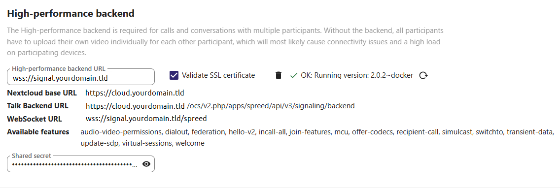

Examples Nextcloud HPB configuration
Example 1
Example 2
grafik
