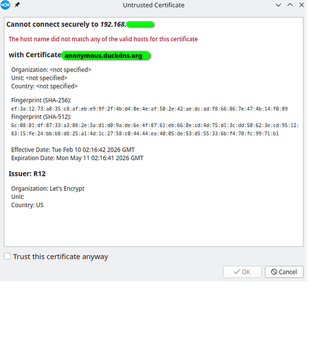

Hello all! I’m having some trouble with ye olde ā€œUntrusted Certificateā€ popup on a self-hosted home server. Please help, even if you need to tell me I’m making a newbie mistake. :smiley:
What do I want: To stop getting the ā€œUntrusted Certificateā€ warnings upon which I need to check ā€œTrust this certificate anyway.ā€ AND to ensure that my home setup is ā€œsafe enoughā€ for a bare-bones basic home server.
What is my setup / problem: I’m running the nextcloud snap on a laptop running ubuntu server. I can access and move files, but I get this popup warning, and every now and then a computer will reject the server entirely, often claiming something like ā€œunacceptable certificate.ā€ But according to the image I’ve shared below, and according to the process I followed ( How to manage Lets Encrypt for Nextcloud snap ), I think I do have valid certificates from Letsencrypt. I’ve tried rebooting, wiping certificates, reinstalling the server etc…

Hi @maguster,
you’re trying to connect using the IP address (192.168.*.*). But a certificate is always bound to a domain name (anonymous.duckdns.org) and NEVER to an IP address.
Your message clearly states this:
You need to configure your local DNS so that your domain points to the local IP address on your local network and connect only using the domain-name.

I do not think you have any missconfiguration within you NC-Server Config. It seems you have a valid Let’s Encrypt Certificate and it will be also renewed all 90 / 45 days. So all is fine.
The Problem is within your LAN you use the IPv4-Adress of the NC-Server and not its FQDN (Fully Qualified Domain Name), what is recommended.
Have you ever tried to edit your local Doman Name Server (DNS). Every LAN has one. Mostly its part of the Router or your local Firewall. Simple home Network Routers like most gets from its Cable, DSL or Fiber ISP’s use internal TLD’s (Top-Level-Domains) like localdomain or such.
So the internal name of your NC-Server is somewhat like nextcloud.localdomain. WHat you now have to do is simply set an aliasname for your NC-Server in your Routers DNS or your Firewalls DNS. Depending on the DNS what is used this might be an alias like:
  • anonymous.duckdns.org -> 192.168.xxx.yyy (xxx.yyy need to be replaced with your NC-Servers IP) or
  • anonymous.duckdns.org -> nextcloud.localdomain
With such a setup all local clients within your local network using the Routers or Firewalls DNS will be able to use the FQDN of your NC-Server and will get as result the IPv4-Adress. Outside of your LAN they will use another DNS and will be able to use also the FQDN and access the NC-Server using NAT and Port forwarding.
Hey! @adelaar I think this solved my problem!
When I first had set up my home nextcloud server, I could only access anonymous.duckdns.org when I was not on my home network. I couldn’t figure out why, so I pointed all my home computers/phones at the server’s IP (192.168.xxx.yyy) and it was able to function for file sharing, albeit getting the untrusted domain popup. I do think I already had the top part of my /etc/hosts/ set up properly (that’s my FQDN?). Side note, I cannot remember if my work computer (i.e. that stays at my workplace) ever received the ā€œuntrusted domainā€ error. But now, after editing my /etc/hosts/ by appending the line 192.168.xxx.yyy anonymous.duckdns.org, all home devices did not have the error popupI
