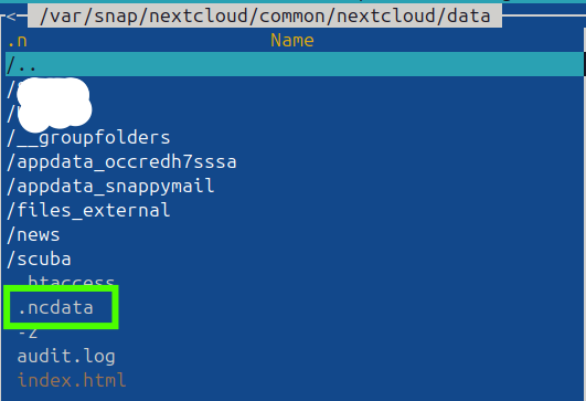

can you locate .ncdata or .ocdata in /data ? if not, then you haven’t run first setup?
are you moving or defining the data directory?
So it looks like when you move data, it doesn’t move .ncdata
sudo mv /var/snap/nextcloud/common/nextcloud /mnt/ssd/nextcloud
Hence, I can’t find .ncdata in my
/mnt/ssd/nextcloud/data

please be clear, did you move your data?
post the result of:
`sudo la -al /mnt/ssd/nextcloud/data
we’re looking for something like this:
Solution
  1. Disable Nextcloud:
sudo snap disable nextcloud
  1. Create .ncdata
cd /mnt/ssd/user/data/
sudo nano .ncdata
 2.1 Content of the file:
# Nextcloud data directory
  1. Enable Nextcloud
sudo snap enable nextcloud
:face_with_steam_from_nose: :face_with_steam_from_nose: :face_with_steam_from_nose:
