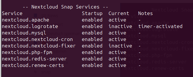

Mine looks like this:
Service Startup Current Notes
nextcloud.apache enabled active -
nextcloud.logrotate enabled inactive timer-activated
nextcloud.mysql enabled active -
nextcloud.nextcloud-cron enabled active -
nextcloud.nextcloud-fixer enabled inactive -
nextcloud.php-fpm enabled active -
nextcloud.redis-server enabled active -
nextcloud.renew-certs enabled active -
But does not renew automatically I always have to run the command and it does indeed renew but not automatically.
Why >? nextcloud.nextcloud-fixer enabled inactive -

that’s perfectly okay, the fixer only runs when its needed. in my first screenshot (testing instance, freshly started) the fixer hadn’t finished
it’ll look like this once the fixer has completed checking:
