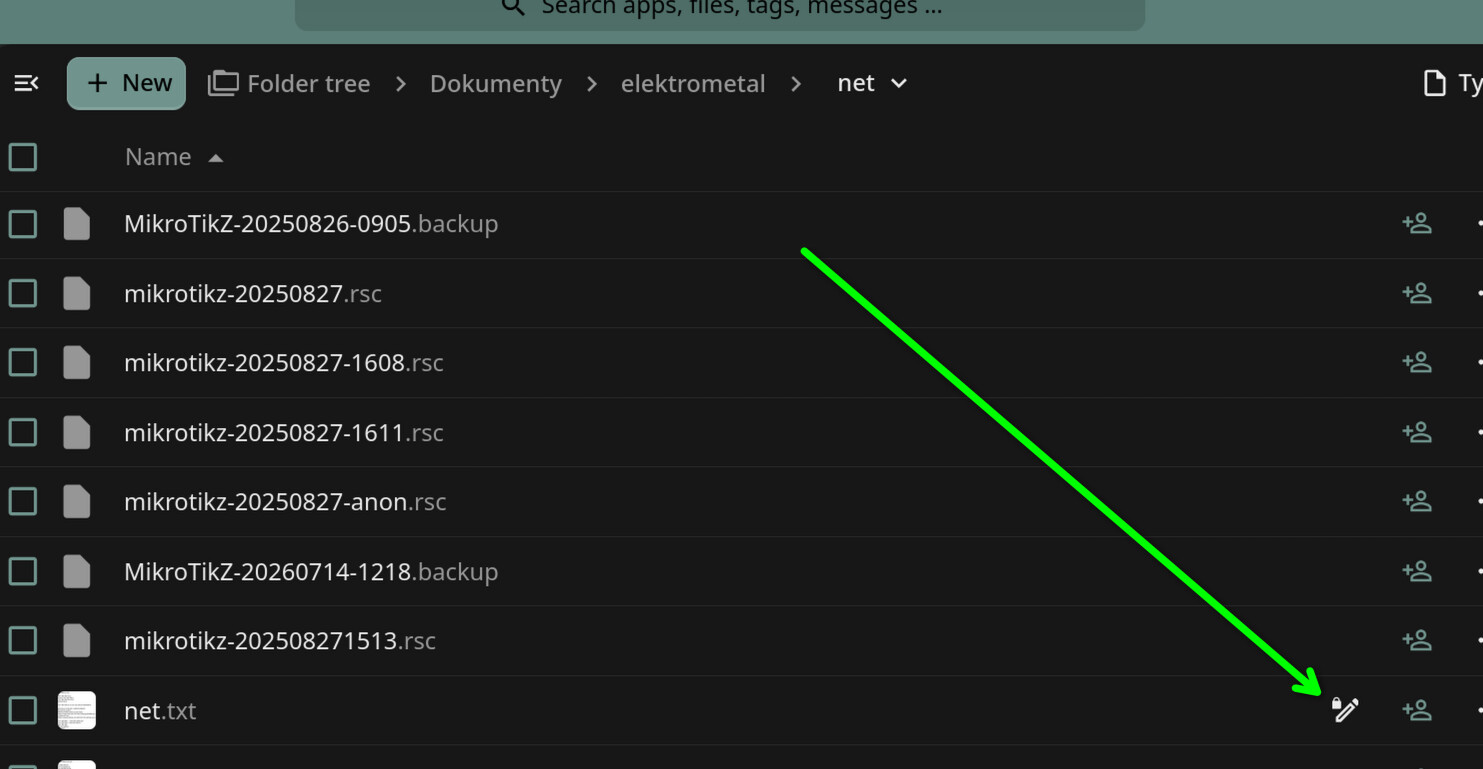

check if you have not edited some files in browser
the icon marked below means brower text editing of a certain file caused a file to get locked for editing, in “details” you can unlock it
