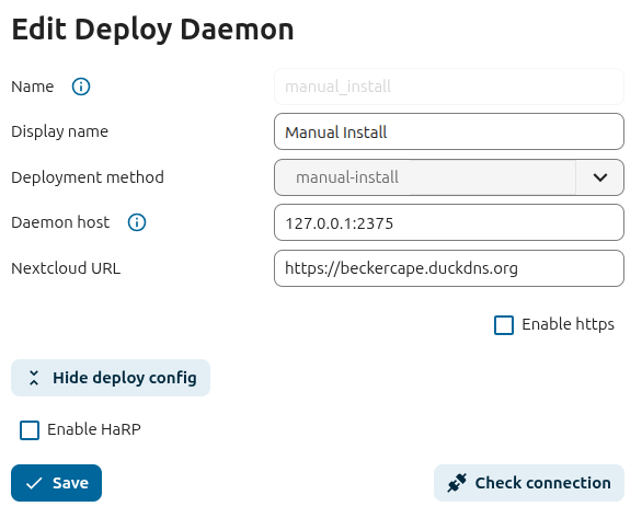

And this is the daemon I set up:
Hey @finco1
there are issues using HaRP with the snap… we’re working on it.
OK. Do you think this is the reason the cookbook is not loading? Is there a reason this would be happening as a result of being behind a proxy rather than no proxy?
that sounds viable… using “HaRP” is a reverse proxy proxied through a reverse proxy.
Thanks for your assistance! I’ll wait for it to get straightened out.
