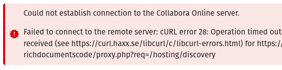

Collabora cURL error 28 - built in Collabora CODE not working
Continuing the discussion from Cannot get Collabora Code Built-in to work:
I have the exact same problem:
and the suggested solution is:
What should I be looking for in the curl response? How do I check which IP it wants to connect to? Could my problem be port forwarding? My server is on a local computer.
There is no error in the curl output for the domain specified above.
Thankfull for any help!
/Martin Book
curl -v provides extended output. check collabora integration guide for more details

Hi, @saettel.beifuss0 !
Thanks for the heads up! I sometimes get a pass on the server and I see this:
Screenshot from 2024-12-14 14-23-17
Next time I click “Use the built-in CODE…” it generally gives me the red error below:
Screenshot from 2024-12-14 14-25-59

I always get a pass on that page.
I get the curl error 28 in the logs (and it also crashed the apache fpm completely).
I am using NGINX as reverse proxy. The problem also exists on 30.0.4 for me.
