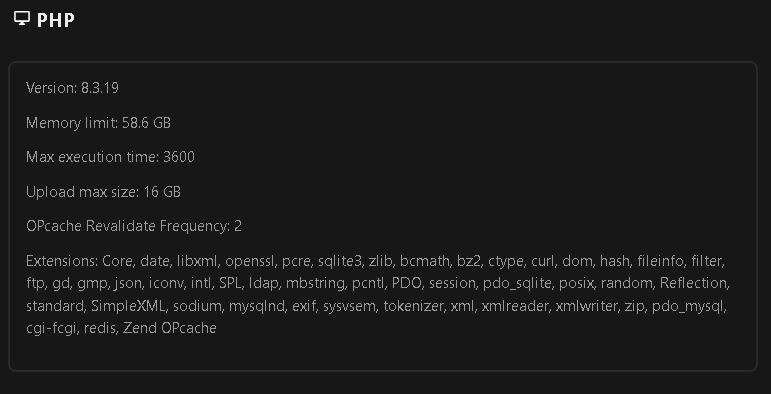

which settings do you mean?
the snap has no thresholds and no restrictions
quick test
Nextcloud snap testing instance
  • create local 2GB file fallocate -l 2G 2GB.img
  • upload file 2GB.img to Nextcloud
upload completed without issues:
