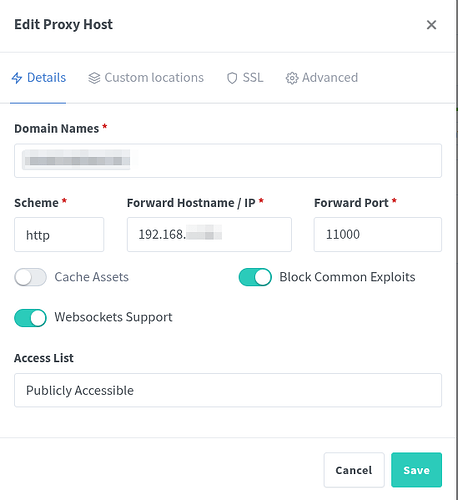

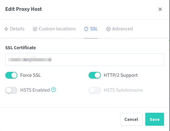

:globe_with_meridians: NGINX Proxy Settings (via NGINX Proxy Manager)
In the Advanced tab for the domain/subdomain:
client_body_buffer_size 512k;
proxy_read_timeout 86400s;
client_max_body_size 0;
:pushpin: Important:
The setting client_max_body_size 0; removes any upload size limit imposed by the reverse proxy, which is essential for handling large file uploads.

Yes, it’s possible. In my setup:
  • Port 6789 is used for the Nextcloud AIO admin interface.
  • Port 11000 is the reverse proxy target for Apache behind NGINX.
Just make sure NGINX forwards to the correct internal port, and that overwrite.cli.url and trusted_proxies are properly set in config.php.
