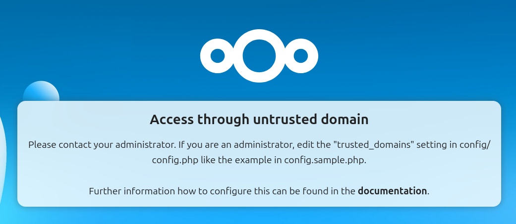

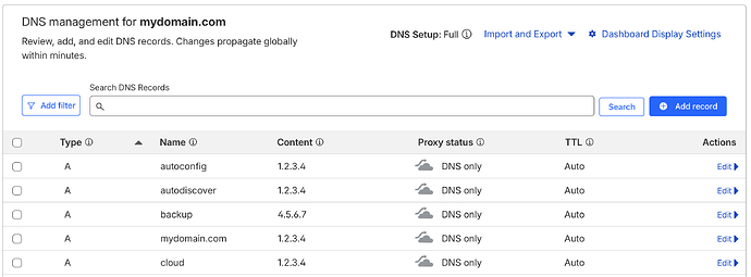

After failing last year to set up Nextcloud last year I’m having another go starting from scratch! I flashed the disk image, booted up the RPi and set up port forwarding. I have a static IP address so have not set up DDNS, I have just pointed my domain name to redirect to my IP address. I can now connect to my Nextcloud both from inside and outside my local network using either the IP address or the domain name, although I get the warnings about it being an untrusted site and I have to click through the options to ignore the warnings and go to it anyway.
So basically, as far as I can tell, everything is working EXCEPT letsencrypt. I’m just running it from the NextcloudPi panel, I’m just checking the “Active” box, typing in my domain, typing in my email (which happens to be on the same domain, does it matter what email I use?) and hitting Apply, but it’s not working.

OK, I am no expert in CPanel, but will show you how I’ve done the same thing with my DNS provider (Cloudflare). I have merely changed the actual domain name to mydomain.com and the IP addresses I use to 1.2.3.4 and 4.5.6.7 for screenshot purposes:
So, the mydomain.com resolves to 1.2.3.4. Any web server that runs on this IP will answer to a client and display whatever is in the webroot. However, since I have a couple of name-based web servers running on this IP (this is beyond the scope of your setup), if someone types cloud.mydomain.com, the DNS will obviously point them to the same IP my domain points to, but the Nginx server will pick up this request and serve content from the webroot that is dedicated to cloud.mydomain.com. Same goes for other names that indicate 1.2.3.4 as target. Obviously, if someone types backup.mydomain.com, DNS will point them to completely different IP and a server that runs there.
This is exactly what you want to achieve. If your home.mydomain.co.uk still resolves to your main domain, there is something wrong with the DNS setup. Please check your CPanel for a wildcard record, perhaps this is a culprit? Something to the lines of *.example.com. Or check if your Cpanel expects you to actually put home. (note the dot), Cloudflare doesn’t and adds the dot automatically but YMMV.
HOORAY!! Thank you for your help, all working now!
I found the DNS zone editor settings in cPanel and set the A record there. There was a general hosting service provided DNS settings page which was where I originally set the A record, but I think that because I was using cPanel for the top level domain that must have been overriding these settings, when I added the A record in cPanel then it worked. So I then set the trusted domain and ran nc-letsencrypt from the webUI panel and it’s now all working, both from local network and from outside.
Marvelous. Have fun with your NC!
