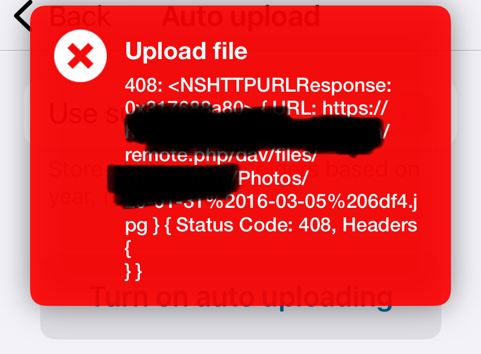

Here is my issue, I have nextcloud AIO running on Ubuntu VM with portainer management. Nextcloud AIO is running behind Cloudflare tunnel FYI.
Now I install nextcloud app on my iPhone and started auto upload of my images and videos. The most I have is 95gb of pictures, videos and files.
I have tailscale running on all my machines including my hyperV that’s running the nextcloud VM that’s solely for nextcloud.
Anyways whenever I am in the nextcloud app on my iPhone, for the life of me I can’t figure out why I am getting these error messages when my files are uploading to my nextcloud server.
I spend hours trying to find a solution online with any kind of documentation but I am a bit lost and as I said, I’m new to nextcloud.
Thank you for taking the time out to help me with this issue!
I would really appreciate if anyone knows a solution for this, or at the very least provide some insight on what could be the possible causes.

One thing that comes to mind that might cause problems like this is that, afaik, Cloudflare tunnels have some file size limitations, especially with the free plan, you might also want to look into that specifically when doing your research…
So I think I found the resolution to this issue. When I was logged on to the ios nextcloud app on my iphone, I was logging on as my.domain.com but I should have logon as https://my.domain.com.
After doing that and resetting the app, review the logs and review uploads, I did not get anymore of the errors. Thank God! before that I also change the max chunked size to 95MB since I am using cloudflare tunnel as well. Putting this here in case anyone also comes across this issue as well.
I take it bad, the issue is still not resolve, wasn’t getting the error all day until just now. This is extremely frustrating cause it doesn’t matter what I google, I can’t find a solution for this!

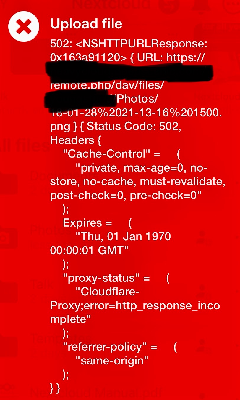

I just increase the php memory from 512 to 1G but same issue. Increase nextcloud server RAM to 26Gb, upload is at 16g and max upload time is at 3600. So idk man, Im at my Witt’s end here.
Maybe it’s cloudflare doing it but maybe there’s something there I can change to fix this? I have rocket loader off as well so idk.

In particular, Cloudflare caused problems with syncing large files — uploads would either fail or endlessly loop. Cloudflare has certain limits and aggressive behavior that doesn’t always play nicely with protocols like WebDAV, especially over tunneled reverse proxies.

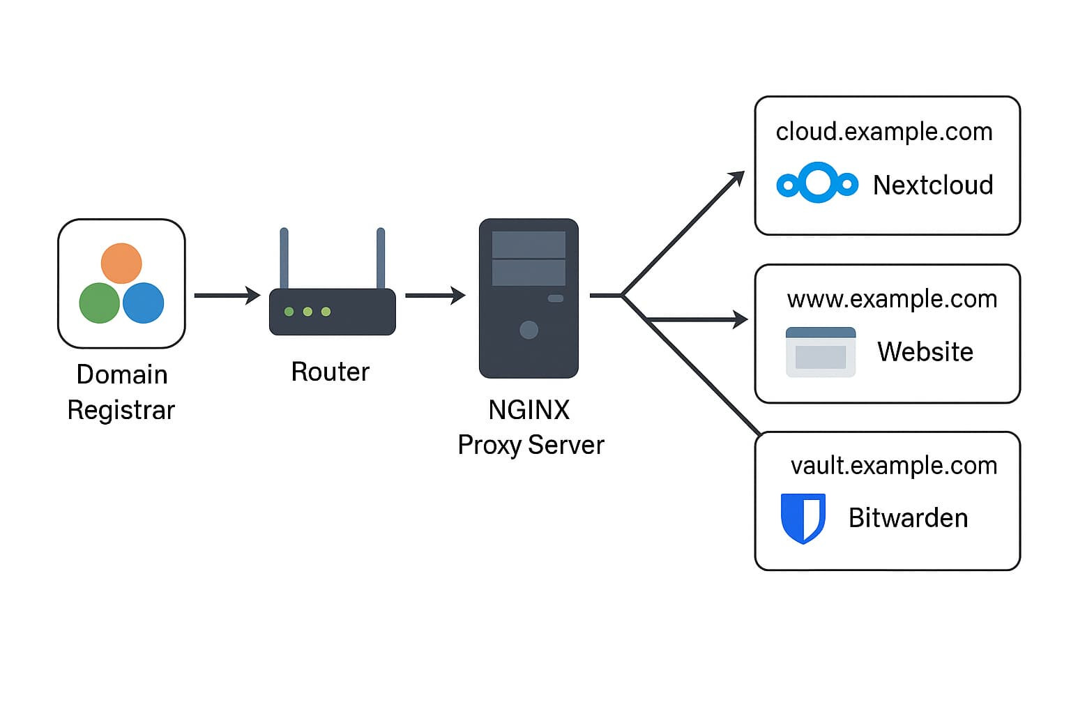

Here’s the model I use that has been rock solid:
nextcloud.mydomain.sk
paid public IP address
router (forwarding ports 443 and 80)
NGINX proxy server (running in a VM on my LAN)
Nextcloud AIO (separate VM on same LAN)
  • SSL certificates are handled automatically via Let’s Encrypt on the NGINX proxy
  • Syncing works perfectly across desktop, mobile, and WebDAV
  • No HTTPS issues, no remote access problems, no outages

  • If you continue using Cloudflare, make sure to disable Rocket Loader, caching, compression, and other “optimizations” for the Nextcloud subdomain — these often cause trouble.
  • Also double-check your proxy headers (X-Forwarded-For, X-Real-IP, etc.) — misconfigured headers often lead to weird behavior with AIO behind reverse proxies.

My thing is cloudflare is a known issue but I also see that tons of other people seems to not have issues with the 502 error so I’m wondering if it’s because they are behind NPM? Idk, I’m not uploading a lot of big files, it’s just my iPhone and my dad new desktop right now.
After the initial upload is done, it just be uploading new picture and stuff that won’t be over 1G :man_shrugging:t5:

Even though I am getting these errors, I am still seeing that pictures are being uploaded, just very very slow.
