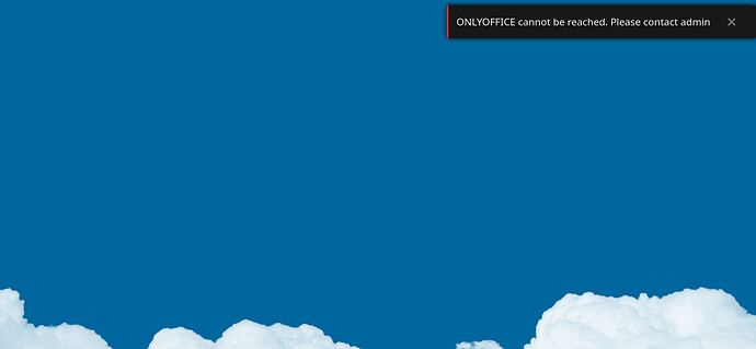

The issue you are facing:
Hello, I have had Nextcloud running for about a week now. Just now noticed that the documents don’t load. I’d been opening the provided ones that come with a new installation and was satisfied that it was working and didn’t realize the others don’t load. Isn’t this supposed to just work on new installs?
Is this the first time you’ve seen this error?: Yes
Steps to replicate it:
  1. Install nextcloud behind reverse proxy with tailscale. (No clear web access, talk works fine, so it’s not the weird setup)
  2. include collabra in containers
  3. Try to create a new document, ensue infinite loading
The output of your Nextcloud log in Admin > Logging: It’s the same error over and over, unrelated I think.

Once I give up on loading it’ll throw this error:
ERR ts=1722880782.8265193 logger=http.log.error msg=read tcp 172.19.0.12:57494->172.19.0.2:9980: read: connection reset by peer request={"remote_ip":"172.19.0.1","remote_port":"59136","client_ip":"100.122.199.7","proto":"HTTP/1.1","method":"GET","host":"nextcloud.wallaby-gopher.ts.net","uri":"/hosting/discovery","headers":{"X-Forwarded-Proto":["https"],"Accept-Encoding":["gzip, deflate, br, zstd"],"Sec-Fetch-Site":["same-origin"],"Sec-Gpc":["1"],"X-Forwarded-For":["100.122.199.7"],"User-Agent":["Mozilla/5.0 (X11; Linux x86_64; rv:128.0) Gecko/20100101 Firefox/128.0"],"Cookie":["REDACTED"],"Sec-Fetch-Dest":["empty"],"Accept":["*/*"],"Accept-Language":["en-US,en;q=0.5"],"Dnt":["1"],"Priority":["u=4"],"Sec-Fetch-Mode":["no-cors"],"Te":["trailers"],"X-Forwarded-Host":["nextcloud.wallaby-gopher.ts.net"]}} duration=694.960393373 status=502 err_id=6kxerk504 err_trace=reverseproxy.statusError (reverseproxy.go:1269)
Output errors in nextcloud.log in /var/www/ or as admin user in top right menu, filtering for errors. Use a pastebin service if necessary.
[05-Aug-2024 17:43:40] NOTICE: fpm is running, pid 569
[05-Aug-2024 17:43:40] NOTICE: ready to handle connections
Activating Collabora config...
āœ“ Reset callback url autodetect
Checking configuration
šŸ›ˆ Configured WOPI URL: https://nextcloud.wallaby-gopher.ts.net
šŸ›ˆ Configured public WOPI URL: https://nextcloud.wallaby-gopher.ts.net
šŸ›ˆ Configured callback URL:
Failed to fetch discovery endpoint from https://nextcloud.wallaby-gopher.ts.net
cURL error 28: Operation timed out after 5002 milliseconds with 0 bytes received (see https://curl.haxx.se/libcurl/c/libcurl-errors.html) for https://nextcloud.wallaby-gopher.ts.net/hosting/discovery
sh: /var/www/html/custom_apps/richdocumentscode/collabora/Collabora_Online.AppImage: not found
NOTICE: PHP message: richdocumentscode (proxy.php) error exit, PID: 638, Message: no_glibc

Things I’ve tried:
  1. Navigated to my rich documents https://nextcloud.wallaby-gopher.ts.net/settings/admin/richdocuments
    It had said failed to curl
    so I thought I’d use the built in code which said I needed to install Collabora Online - Built-in CODE Server, so I did and got a slightly different error
  2. I found this guide for when Collabra needs help even though it’s supposed to install itself: link
I ended up downloading two more apps based on that: Community Document Server Version 0.1.18 and ONLYOFFICE. This just resulted in a new error:
3.Uninstalling all of these apps now:
I can get a green light when no radio button is selected:
but behavior is the same, and returns to step 1.'s WOPI image upon selecting an option.
  1. Trying this guide with integrating collabra. I get stuck on step 2 of troubleshooting docker exec nextcloud-aio-collabora curl https://nextcloud.wallaby-gopher.ts.net/hosting/discovery -v
    It just gets stuck, no errors:
% Total    % Received % Xferd  Average Speed   Time    Time     Time  Current
                                 Dload  Upload   Total   Spent    Left  Speed

Thank you in advance for you help!

yes but AiO doesn’t use built-in CODE… technically it is still a separate container… but it still shares the same public FQDN… I’m not sure your reverseproxy config requeires additional config. did you check AiO reverse proxy docs already?
So when I run docker exec nextcloud-aio-collabora curl https://nextcloud.wallaby-gopher.ts.net/hosting/discovery -v the caddy logs are suspiciously quiet. I can’t even get the below error I used to when I gave up loading a document. It’s just nothing now.
ERR ts=1722969422.6588783 logger=http.log.error msg=read tcp 172.18.0.2:43494->172.17.0.1:11000: read: connection reset by peer request={"remote_ip":"100.122.199.7","remote_port":"46162","client_ip":"100.122.199.7","proto":"HTTP/1.1","method":"GET","host":"nextcloud.wallaby-gopher.ts.net","uri":"/index.php/apps/notify_push/test/version","headers":{"Accept":["*/*"]},"tls":{"resumed":false,"version":772,"cipher_suite":4865,"proto":"http/1.1","server_name":"nextcloud.wallaby-gopher.ts.net"}} duration=0.000362389 status=502 err_id=qikneuwvx err_trace=reverseproxy.statusError (reverseproxy.go:1269)
Yes, in that page there is no mention of Collabora/Office. On this page for troubleshooting with cloudflare (which seems similar to caddy/tailscale) they mention needing to add to the WOPI, but I can’t even get to that without connecting.
I hadn’t considered a demo server because it wouldn’t be able to access because of tailscale, but tried anyway and while it didn’t work as expected, it threw the exact same error.
although this one is different, not sure why
and got this instead of an infinite load
With a new error in apache
ERR ts=1722982403.8042994 logger=http.log.error msg=read tcp 172.19.0.10:54360->172.19.0.2:9980: read: connection reset by peer request={"remote_ip":"172.19.0.1","remote_port":"57306","client_ip":"100.122.199.7","proto":"HTTP/1.1","method":"GET","host":"nextcloud.wallaby-gopher.ts.net","uri":"/hosting/discovery","headers":{"Accept-Encoding":["gzip, deflate, br, zstd"],"Cookie":["REDACTED"],"Sec-Fetch-Mode":["no-cors"],"Te":["trailers"],"X-Forwarded-Host":["nextcloud.wallaby-gopher.ts.net"],"Accept-Language":["en-US,en;q=0.5"],"Sec-Fetch-Dest":["empty"],"Sec-Gpc":["1"],"X-Forwarded-For":["100.122.199.7"],"User-Agent":["Mozilla/5.0 (X11; Linux x86_64; rv:129.0) Gecko/20100101 Firefox/129.0"],"Dnt":["1"],"Sec-Fetch-Site":["same-origin"],"Accept":["*/*"],"Priority":["u=4"],"X-Forwarded-Proto":["https"]}} duration=139.551445256 status=502 err_id=43nb2mbdm err_trace=reverseproxy.statusError (reverseproxy.go:1269)
where this line comes from? /index.php/apps/notify_push/test/version sounds like this message is intended for your Apache but it fails?
assuming your CODE container has 172.19.0.2 the access is supposed to work. But there is one more issue I see in the screenshot above - you **client"" is unable to resolve public DNS? why? and in general does the DNS resolution inside of containers provide expected results?
Hmm. These networking questions may be beyond me. I’ve definitely been having trouble with DNS on my pc for some reason, like I can’t ping google.com it just gets stuck:

      #- /media/server/server/jellyfin-server/cache:/cache
      - jellycache:/cache
      # ro means read only, we don't want jellyfin accidentally deleting our files
      - /media/16d1/Shows and Movies/Movies:/Movies:ro
      - /media/16d1/Shows and Movies/Shows:/Shows:ro
      #- /media/16tb/Books:/Books:ro
      - /home/drm/Music:/music:ro
    restart: unless-stopped
    runtime: nvidia
    deploy:
      resources:
        reservations:
          devices:
            - capabilities: [gpu]
    depends_on:
      - caddy
  #audiobooks, does better than Kavita for ebooks too
  audiobookshelf:
    image: ghcr.io/advplyr/audiobookshelf
    volumes:
      - /media/16d1/Books/Audiobooks:/audiobooks
      - /media/16d1/Books:/books
      #- </path/to/podcasts>:/podcasts
      - audioc:/config
      - audiom:/metadata
    environment:
      - TZ=America/Chicago
  caddy:
    build:
        dockerfile_inline: |
          FROM caddy:2-builder AS builder
          RUN xcaddy build latest \
            --with github.com/tailscale/caddy-tailscale
          FROM caddy:2
          COPY --from=builder /usr/bin/caddy /usr/bin/caddy
    hostname: caddy
    container_name: "caddy"
    extra_hosts:
      - "host.docker.internal:host-gateway"
    ports:
      - "80:80"
      - "443:443"
      - "443:443/udp"
    volumes:
      - caddy:/data
      - tailscale:/tailscale
    configs:
      - source: Caddyfile
        target: /etc/caddy/Caddyfile
  #nextcloud
  nextcloud:
    image: nextcloud/all-in-one
    restart: always
    volumes:
    ports:
      - 8080:8080
      # - AIO_DISABLE_BACKUP_SECTION=false # Setting this to true allows to hide the backup section in the AIO interface. See https://github.com/nextcloud/all-in-one#how-to-disable-the-backup-section
      #- SKIP_DOMAIN_VALIDATION=true #might not be helping?
      - APACHE_PORT=11000 # Is needed when running behind a web server or reverse proxy (like Apache, Nginx, Cloudflare Tunnel and else). See https://github.com/nextcloud/all-in-one/blob/main/reverse-proxy.md
      - APACHE_IP_BINDING=0.0.0.0 # Should be set when running behind a web server or reverse proxy (like Apache, Nginx, Cloudflare Tunnel and else) that is running on the same host. See https://github.com/nextcloud/all-in-one/blob/main/reverse-proxy.md
      # - BORG_RETENTION_POLICY=--keep-within=7d --keep-weekly=4 --keep-monthly=6 # Allows to adjust borgs retention policy. See https://github.com/nextcloud/all-in-one#how-to-adjust-borgs-retention-policy
      # - COLLABORA_SECCOMP_DISABLED=false # Setting this to true allows to disable Collabora's Seccomp feature. See https://github.com/nextcloud/all-in-one#how-to-disable-collaboras-seccomp-feature
      # - NEXTCLOUD_MOUNT=/mnt/ # Allows the Nextcloud container to access the chosen directory on the host. See https://github.com/nextcloud/all-in-one#how-to-allow-the-nextcloud-container-to-access-directories-on-the-host
      - NEXTCLOUD_UPLOAD_LIMIT=1G # Can be adjusted if you need more. See https://github.com/nextcloud/all-in-one#how-to-adjust-the-upload-limit-for-nextcloud
      - NEXTCLOUD_MAX_TIME=3600 # Can be adjusted if you need more. See https://github.com/nextcloud/all-in-one#how-to-adjust-the-max-execution-time-for-nextcloud
      - NEXTCLOUD_MEMORY_LIMIT=1024M # Can be adjusted if you need more. See https://github.com/nextcloud/all-in-one#how-to-adjust-the-php-memory-limit-for-nextcloud
      # - NEXTCLOUD_TRUSTED_CACERTS_DIR=/path/to/my/cacerts # CA certificates in this directory will be trusted by the OS of the nexcloud container (Useful e.g. for LDAPS) See See https://github.com/nextcloud/all-in-one#how-to-trust-user-defined-certification-authorities-ca
      # - NEXTCLOUD_ADDITIONAL_APKS=imagemagick # This allows to add additional packages to the Nextcloud container permanently. Default is imagemagick but can be overwritten by modifying this value. See https://github.com/nextcloud/all-in-one#how-to-add-os-packages-permanently-to-the-nextcloud-container
      # - NEXTCLOUD_ADDITIONAL_PHP_EXTENSIONS=imagick # This allows to add additional php extensions to the Nextcloud container permanently. Default is imagick but can be overwritten by modifying this value. See https://github.com/nextcloud/all-in-one#how-to-add-php-extensions-permanently-to-the-nextcloud-container
      # - NEXTCLOUD_ENABLE_DRI_DEVICE=true # This allows to enable the /dev/dri device in the Nextcloud container. āš ļøāš ļøāš ļø Warning: this only works if the '/dev/dri' device is present on the host! If it should not exist on your host, don't set this to true as otherwise the Nextcloud container will fail to start! See https://github.com/nextcloud/all-in-one#how-to-enable-hardware-transcoding-for-nextcloud
      - TALK_PORT=3478 # This allows to adjust the port that the talk container is using. See https://github.com/nextcloud/all-in-one#how-to-adjust-the-talk-port
      # - WATCHTOWER_DOCKER_SOCKET_PATH=/var/run/docker.sock # Needs to be specified if the docker socket on the host is not located in the default '/var/run/docker.sock'. Otherwise mastercontainer updates will fail. For macos it needs to be '/var/run/docker.sock'
    depends_on:
      - caddy
  #for nextcloud office to work
  collabora:
    image: collabora/code
    container_name: collaborac
    ports:
      - 9980:9980
    environment: #--o:security.capabilities=false did not help with phone backspace either
      - username=admin
      - password=Secret.Password
      - extra_params=--o:ssl.enable=false --o:ssl.termination=true
      #- dictionaries=en
    cap_add: #- SYS_ADMIN sometimes needed due to permission issue, - CHOWN no difference?
      - MKNOD
      - SYS_ADMIN
    #tty: true
    depends_on:
      - nextcloud
Maybe FYI, there is now a dedicated tailscale guide:
https://github.com/nextcloud/all-in-one/discussions/5439
