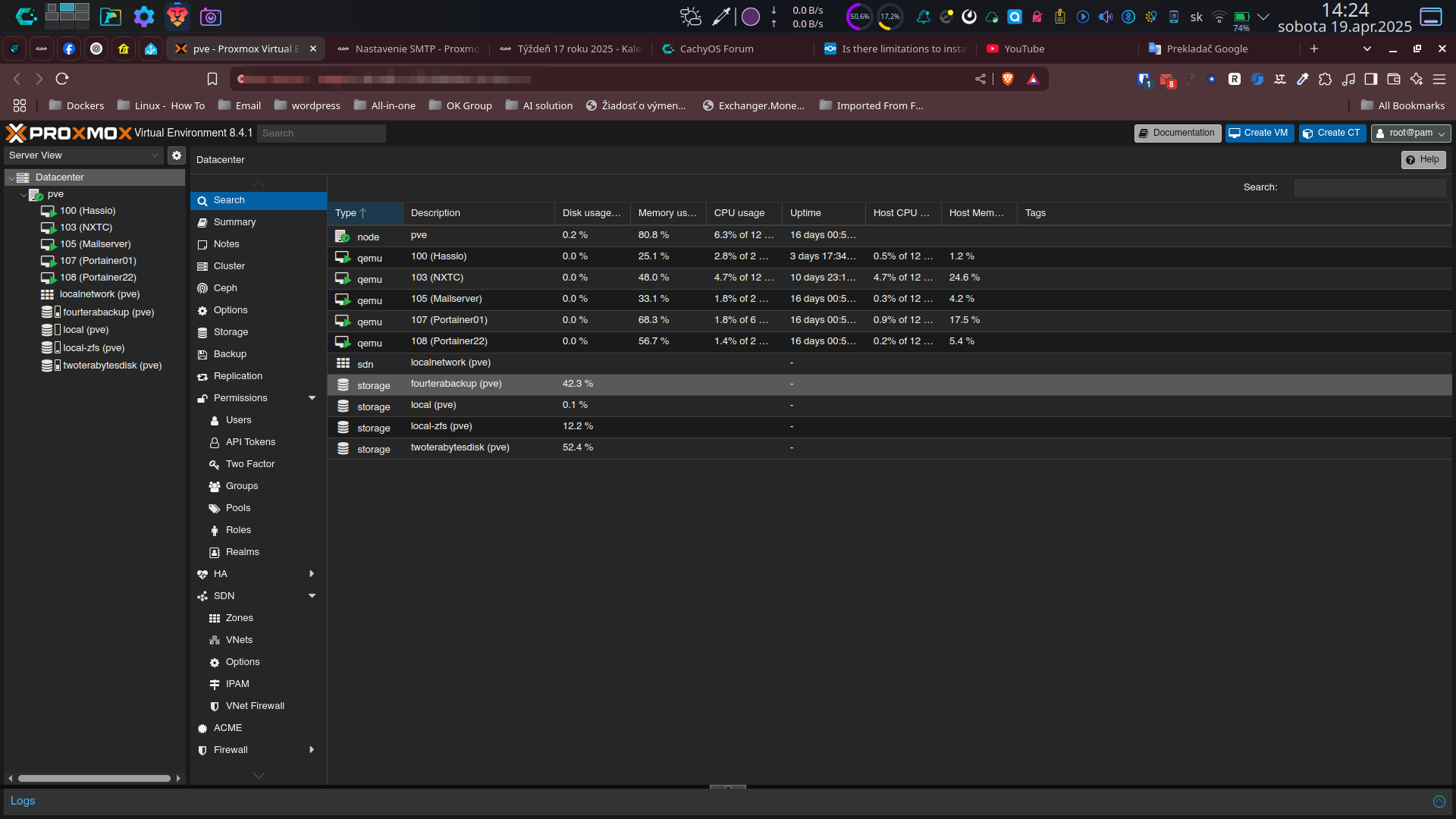

I have installed a Nextcloud on a container on Proxmox using the template on the printscreen, my question is if there’s any limitations by installing it this way, beacause i’m gonna use automated scripts on other networks, i already have a DNS pointing to its IP working and i’m planning on using WebDAV for this
