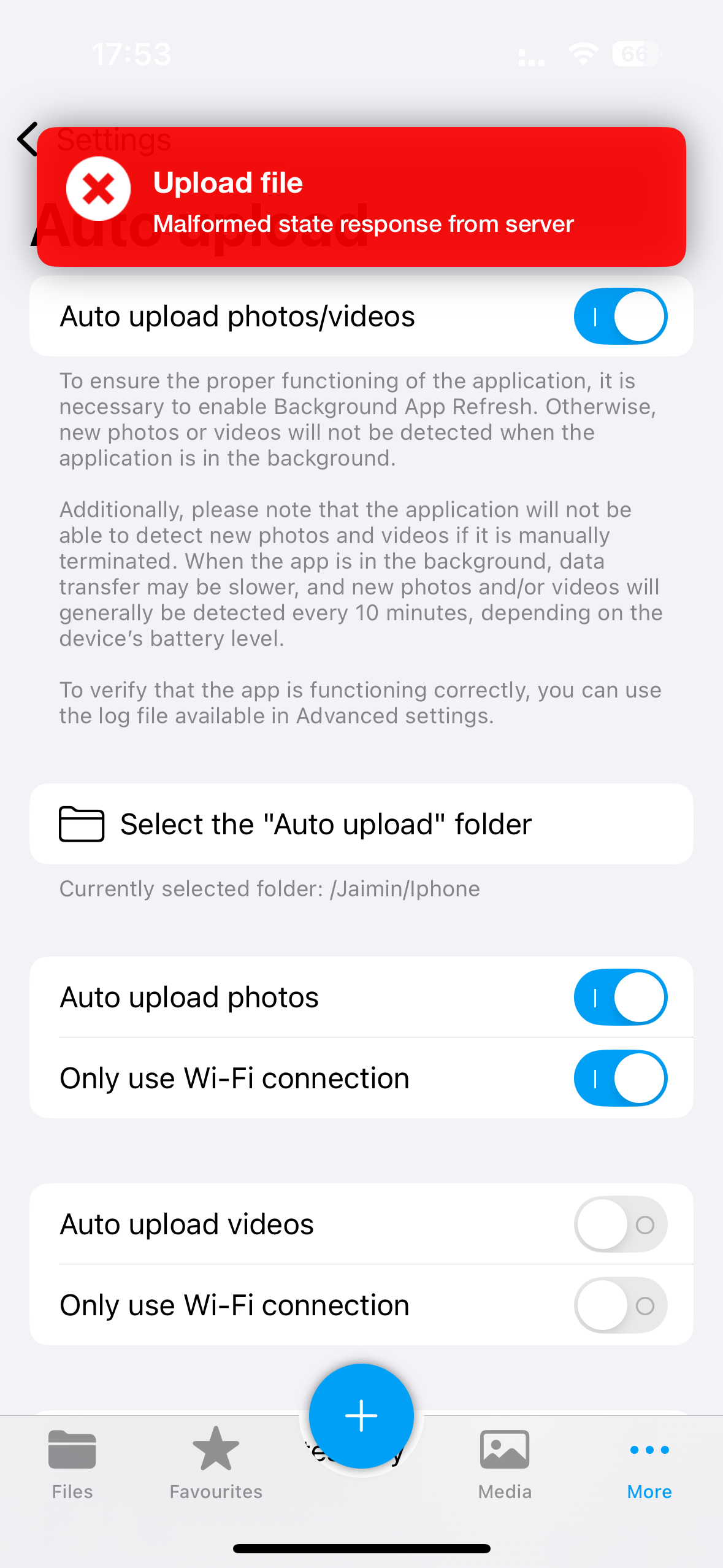

i seeing internal server error on my phone’s app but i dont have screen shot and even ialso have new error called UPLOAD FILE Malformed state response from server will attach screen shot now.
Now according to this screenshot it appears after once there is a upload of about 8 to 9 GB that is about (45500 to 5000 photos)

[webdav] Error: Icewind\SMB\Exception\Exception: Malformed state response from server at <>

This suggests your SMB server is sending a malformed response at some point along the way. It means the response that came from the SMB server when Nextcloud tried to stat() the file is not all in an expected format.
One thing that stands out here is that you appear to be using the smbclient binary wrapper rather than the native PHP smbclient. Before troubleshooting this much, I’d switch. It should have better performance anyhow. And due to how it works it may be less likely to hit a parsing issue (at least if it’s a valid response).
