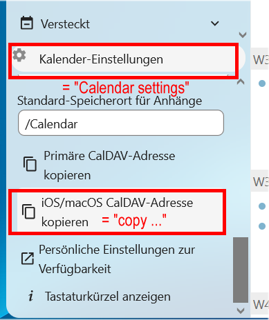

I never heard, tha a profile must be downloaded on a IOS device.
Normally calendar- and contacts sync will be configured in the app DavX5.
Just enter the link from calendar within Nextcloud using browser - see lower left corner:
The copied link looks like this:
https://nextcloud.mydomain.de/remote.php/dav/principals/users/< username >/
Paste this link in DavX5 while configure it. Then mark the contacts and calendars you want to synchronize and have a look on the item “Certificate Validation”, whether to ignore or validate it.
(I only use Android devices, but on IOS it should be similar)
