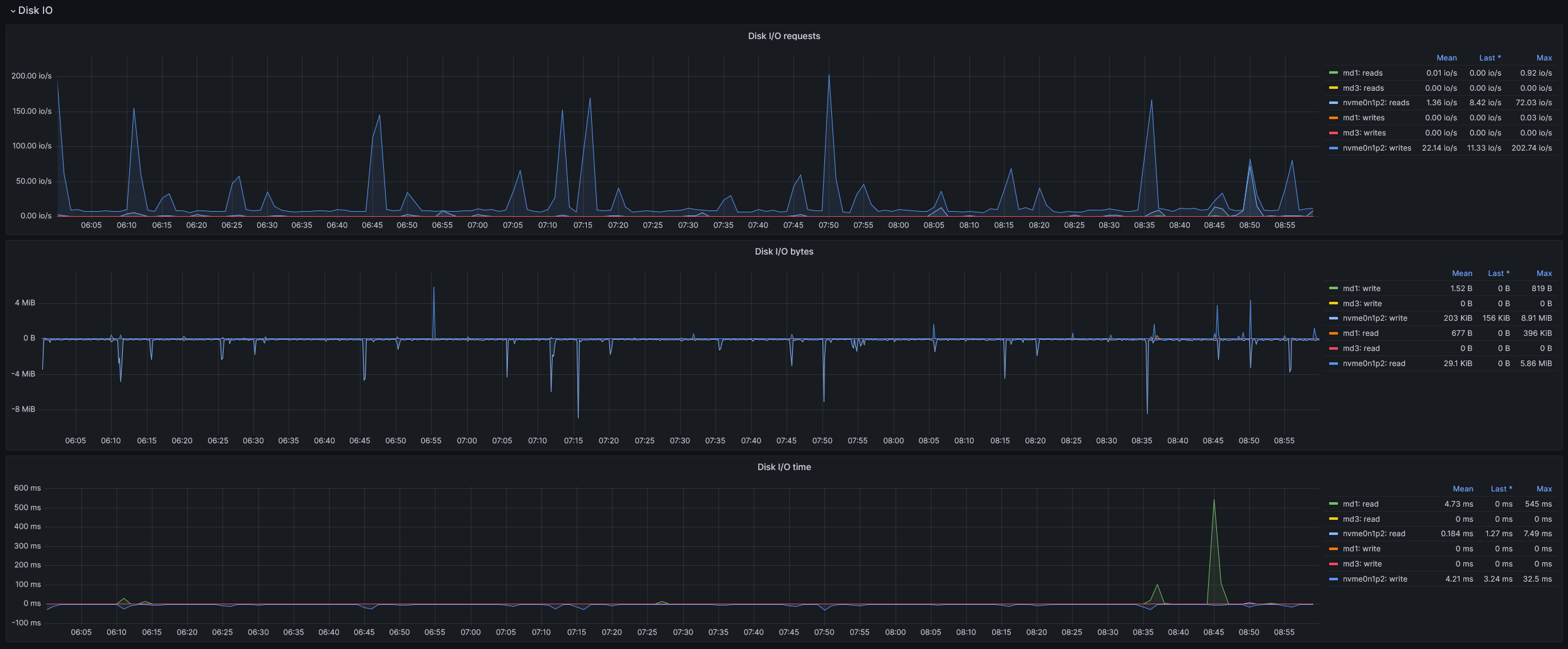

CPU Load:
Disc I/O Load:
  • The data is stored on conventional HDDs.
  • NC itself and the database on a NVMe SSD
  • High load is only on one core. But this core is then constant to 100% load.
  • There are no error messages. Neither in the cron_nc.log nor in the NC instance itself.

The Nextcloud cron currently runs every 5 min, as 10:45, 10:50, 10:55 …
Does anyone have a guess what is started at 10:50 am/pm in the cron?
Can this possibly be read out?
