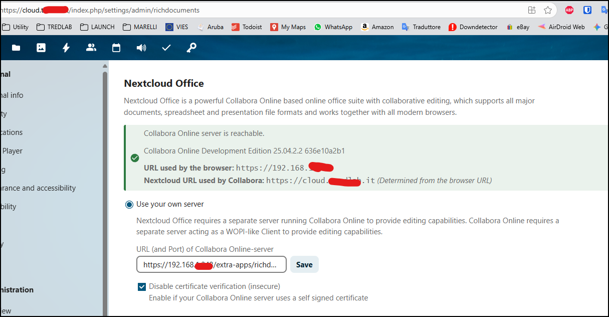

grafik
Built-in CODE & Nextcloud office is tested by default for each Nextcloud snap release;
I don’t think this is true as visible in this screenshot:

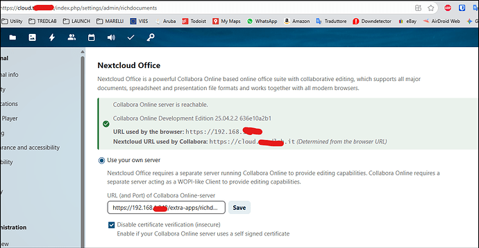

yes i have green checks when access with cloud.mydomain.com and with local IP. If i remove the tick ā€œdisable certificate verificationā€ i have red error.
Failed to connect to the remote server: cURL error 51: SSL: no alternative certificate subject name matches target host name '192.168.***.***' (see https://curl.haxx.se/libcurl/c/libcurl-errors.html) for https://192.168.***.***/extra-apps/richdocumentscode/proxy.php?req=/hosting/discovery
When access with local IP, in nextcloud offce setting i have selected use built-in code
If you’re using the built-in CODE server (richdocumentscode), you don’t need to configure anything manually—just make sure the ā€œUse built-in CODE serverā€ option is enabled.
If it still doesn’t work, it’s likely because the client doesn’t trust the self-signed certificate, or it might still be trying to connect via the URL you previously used. In that case, try switching to ā€œUse your own serverā€ and then back to ā€œUse built-in serverā€ā€”that can sometimes reset things.

your screen shot says something else… please double check you settings. we’ve discussed that previously already!
the strange thing that happen ( i don’t know if it’s normal) is that when i access with local IP and check the setting, is selected built in code, while if access with cloud.mydomain.it it automatically select ā€œuse your own serverā€ and put the local IP address
