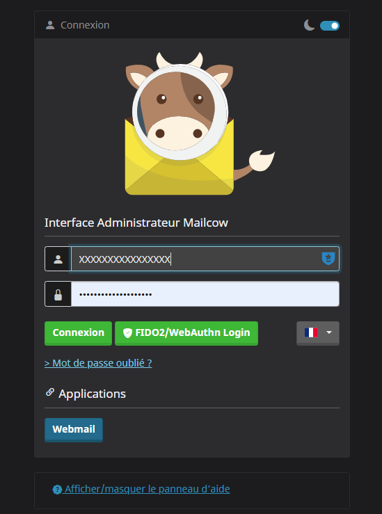

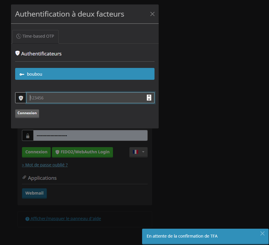

on my mail server that I administer there is double authentication on the mailboxes with the management interface, and for outlook and the rest this is done with tokens… So saying that there is no double authentication on the mailboxes is false.
