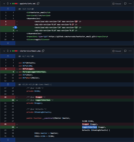

The “twofactor_email” application works again on NC31. You only need to modify two files in the twofactor_email app folder to make it compatible. See the Github link at the bottom of the post:
“appinfo/info.xml” and “lib/Service/Email.php”
Github link
Thanks to NielBuys for his work.
Update: The app has been updated on the Nextcloud store
