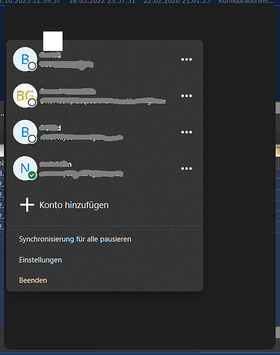

Either this is new or I didn’t notice it by now: When clicking in the upper left corner of the blank popup I get the account overview.
