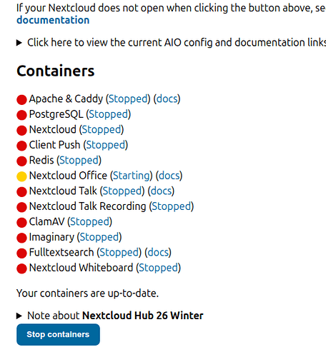

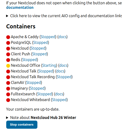

This is what my admin page currently looks like:
