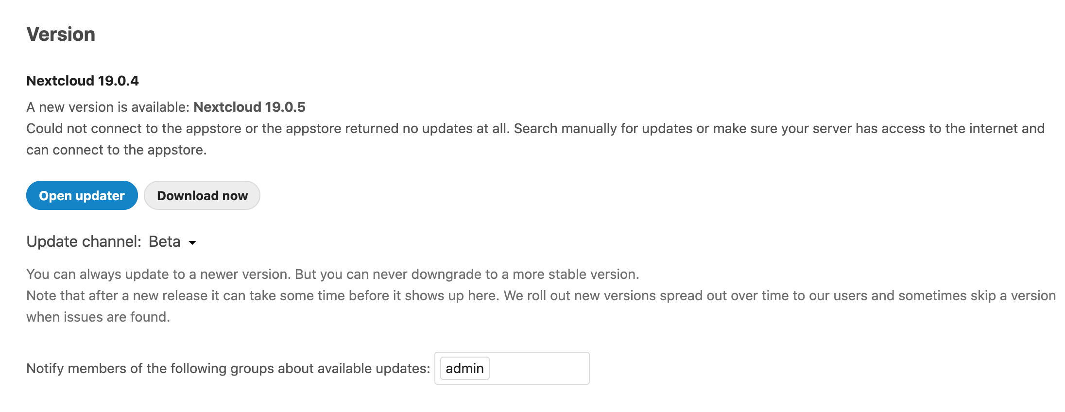

If the the 20.0.x releases are ā€œstableā€, then why aren’t they offered as an option for download within the stable branch channel? I have to switch branches in order to have the option to download and install 20.0.x.
Others have posted above, that 20.0.1 and 20.0.2 were not meant for ā€œstableā€ distribution and encouraged users like me to wait until the 20 release appeared within the stable branch release pipeline.
I’m not here to argue with anyone about what’s classified as stable or not, its just the numbering scheme is very very confusing. I’m being offered 19.0.5 right now within the stable channel. I’m not aware of any source (link or otherwise) that actually explains releases numbers. You would probably disagree with me, but my question was more focused because I was confused and I couldn’t find a definitive source that explained the issue. I believe someone above suggested a user like to me to check the forums before posting such an issue – this made me laugh. I like the forums a lot and contribute when I can however there is a lot of misinformation floating around the forums. It hard to get a clear direction sometimes if I followed every post regarding a particular topic posted within the forums.

great so why not updating to 19.0.5? do that. After that you should find nc 20.0.2 at least offered in the beta-channel… and as i told you above i found the update from 18 to 19 only with 19.0.2. in the stable channel.
i don’t see your problem. if you want to update to nc20 - you know what to do. v20.x IS considered stable. (see above).
sure thing. but nothing is as easy to explain as the channel-ā€œissueā€.
in short:
  • beta and RC-versions are considered beta and thus won’t never make it into any stable channel. PLUS: they are marked beta or RC.
  • x.0.0+ versions are considerd stable and thus pushed to the stable channel.
  • if you won’t get offered a new version via stable channel there can be several reasons for it (see above for some of them)
  • if you want to upgrade though - you now know the trick to get the desired version though.
@Rhinox
what do you want me to do for you? the behaviour of your instances clearly show that it is exactly like is just said. staged rollout, some instances could update others not. so what?
only if your version is equal or higher then 20.0.0
that means that the one who is missing is version 19.0.5 or smaller while the other twos where already 20.0.0 or higher.

if you’d ask ā€œwhat’s the latest NC releaseā€ the correct answer is:
NC 18, version 18.0.11
NC 19, version 19.0.5
NC 20, version 20.0.2
All 3 versions are maintained and so far up to date and patched with the latest patches.
So if you’d still be on NC18 the latest version would be 18.0.11 - completely up to date.
You’re detecting a problem here on the forum in the way of communicating? Well grab your own nose and start asking correctly at first. This might avoid misunderstandings.
Apparently you run NC 19. So the latest release FOR YOU will be NC 19.0.5. It was released yesterday.
yes. But apparently not for your instance right now. Why not you might ask? Easy: see the above discussion. Keywords: staged rollout, meeting requirements etc.
What is as problematic for you to understand this? It’s really easy.
@kevdog
If you start upgrading to 19.0.5 you will most likely be offered 20.0.2 in the beta channel.
