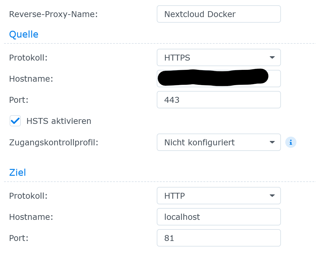

The container runs behind a reverse proxy that only allows https.
Also in the config I have set ‘overwriteprotocol’ => ‘https’,
I don’t redirect anything on my own, the .htaccess is part of the container.

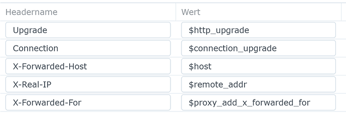

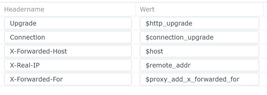

looks like your reverseproxy is doing the redirect..
again, I don’t know how this post is supposed to help.
I set up the container based on the documentation, taking into account the config settings for the reverse proxy.
Those are the settings of the reverse proxy. Same settings are mentioned in tutorials and the nextcloud-aio github page.
The redirect works for anyone outside, based on your explanation, the redirect is not working on the server side.
Still I don’t understand why the error message only shows up for caldav not for carddav.
So, no the reverse proxy is not redirecting /well-known. I can show you the complete reverse-proxy conf file, if that helps.
Please post your actual Nextcloud config (as noted in the support template and do so by using occ config:list system preferably since most of the Docker images used multiple config files + environment variable injection so just looking at config.php isn’t enough) as well as your Docker Compose.
Based on a few clues in the thread so far, don’t believe you’re actually using the AIO image/stack. Possiblly the community micro-services image, but there are other possibilities.
Also, can you clarify specifically what RP you’re using? Standard nginx does not have that UI. It appears to be one of the third party ones, possibly Synology’s.
Yes, it is not the AIO image, it is the community one. I just went through several resources to verify if a special setup for the RP is needed and yes it is the Synology RP.
