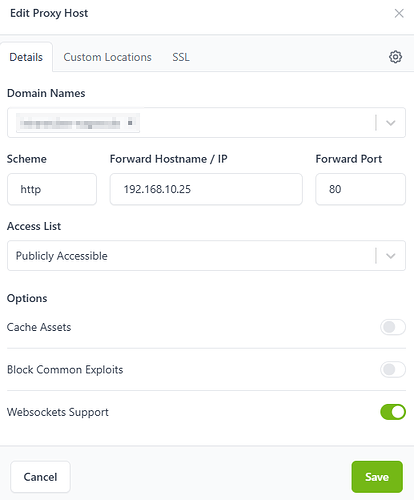

Fritzbox → Portforwarding 80&443 to NginxProxyManager –> Proxy Host created forarding Traffic via Port 80 to my Nextcloud Container. In the container nextcloud is run ning in the subfolder /nextcloud

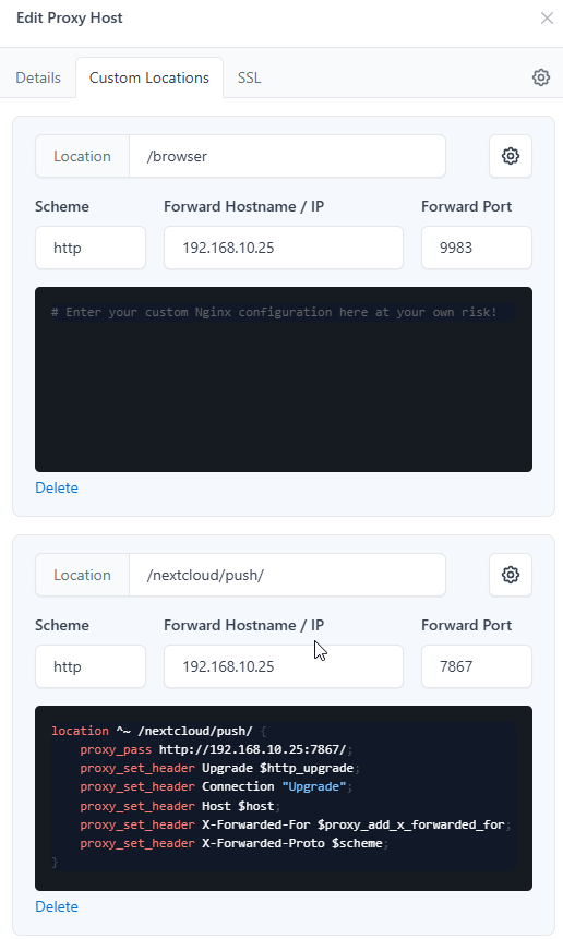

In NGINX NPM i have created the following entry:
What else do I need to do to get this error message away? Some of the settings I had to set otherwise my IOS Devices were not able to connect any longer.

In your 3rd screen shot you have an explicit handler in Nginx/NPM for location ^~ /nextcloud/push/ws/. That’s the culprit in your original configuration. Nginx doesn’t need that, plus the one you have is pointed at the root of notify_push (instead of [...]7867/ws) which wouldn’t be right anyhow.
You can see the documentation that covers this here.
