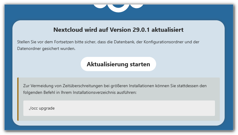

On a shared server I used Nextcloud v25 with PHP 7.4 a long time. Now I wanted to update to the latest versions.
I updated PHP to v8.1 for using the web updater of Nextcloud. The update process workded step by step / version by version – until the update to 29.0.1. I get this message each time I try to “start the update” (also see screenshot below):
Aktualisierung auf 29.0.1
InvalidArgumentException: Index name "lock_key_index" for table "XXX_file_locks_2023-10-06" collides with the constraint on table "XXX_file_locks".

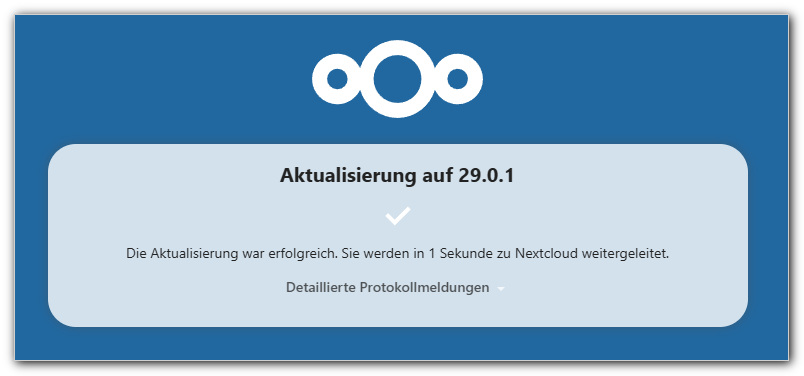

Ah, thanks a lot!
Indeed, I remember: on 2023-10-06 I had synchronisation problems because of locked files and had to clean up the table. So I made a backup of this table – as always with the current date as suffix …
I simply deleted this table und started the update process again. Final result:
