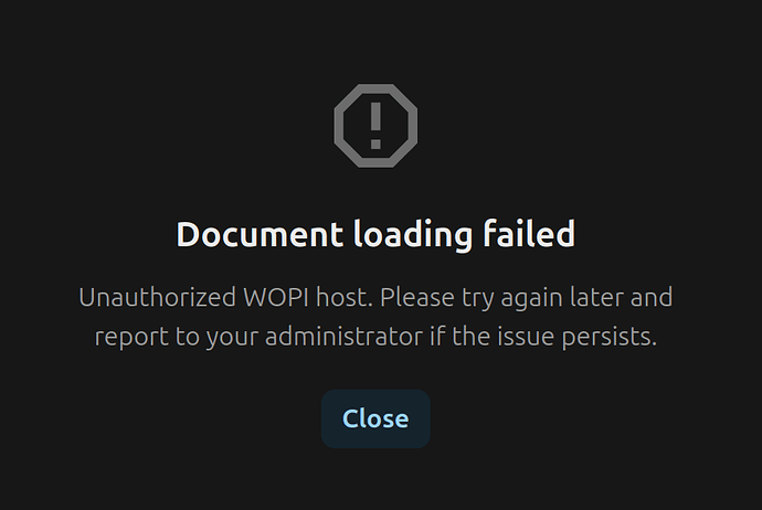

I am not able to open documents on NextCloud, and instead am greeted by this message:
In the troubleshooting guide from Collabora integration guide, the step that fails is access to Nextcloud UI from Collabora. The log results are below.
Given that I installed Nextcloud and Collabora as regular apps on TrueNAS SCALE, many of the more advanced edits to configuration files are out of reach, and above my skill level.

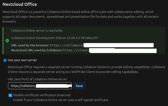

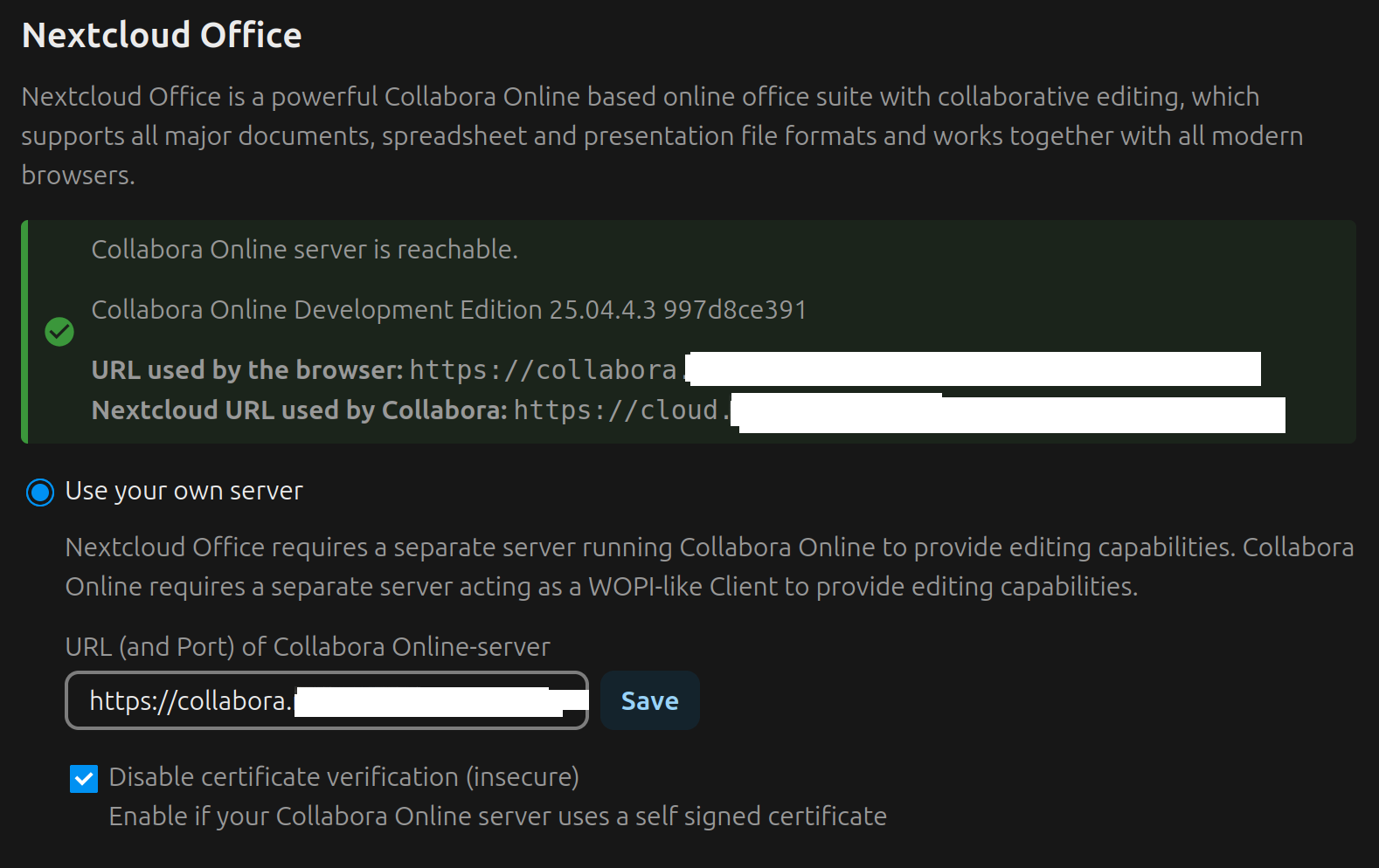

  1. I have Nextcloud and Collabora servers up and running on TrueNAS SCALE. I attempted configuration based on the following:
    The “disable certificate verification” is now unchecked, unlike this image.
  2. I created a new document called “test_collabora.odt” and another .docx. Opening either from Nextcloud produces the same error message re: Unauthorized WOPI Host, as shown above.
