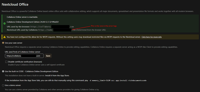

Image of the Admin > Office panel in Nextcloud:

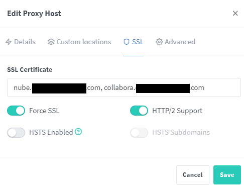

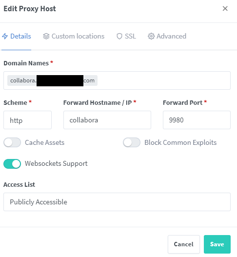

If relevant here are some screenshots of my Nginx Panel for the collabora proxy (Everything is the same for the cloud one except for websockets and http being https):

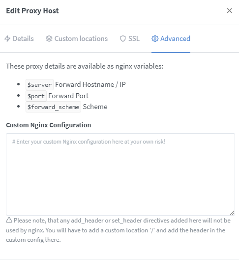

(I tried to add a custom nginx configuration on the advanced tab, but I never managed to make collabora’s proxy be online whenever I tried it)

you find the right syntax to aliasgroups in Important changes regarding COOL/CODE docker versions from v21.11.3.6 on (multiple domains setup)
