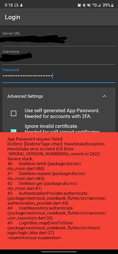

Unable to Log in
Nextcloud version (eg, 20.0.5): 23.0.2
Operating system and version (eg, Ubuntu 20.04): debian 11 from the offical nextcloud docker image
Apache or nginx version (eg, Apache 2.4.25): Apache/2.4.52
PHP version (eg, 7.4): PHP/8.0.16
The issue you are facing:
Steps to replicate it:
  • trying to log into NextCloud Cookbook by Teifun2 using either an app password or my admin credentials.
Nothing is logged even when I intentionally log in with wrong credentials.

I’m fairly new to NextCloud. I recently discovered this add on and it has a lot of potential. i tried to download the Nexcloud Cookbook app by Teifun2 but i can’t log in. i see the error in the screen shot provided. I did follow the steps to create an app password and used it to try and log in. Is it still user error?

Do you have any special configuration regarding your HTTPS server? This seems (from the error messageand without further knowledge) to be an incompatibility of your mobile’s operating system and the server.
Are you using https (also in the Server URL field)?
To check your security settings:
Go to the server in your desktop browser (I use Firefox, Chrome should be similar). Next to the address, there is a small lock. (Sorry, currently I cannot upload a screenshot) There is a message like The connection is secure or similar. Click on it and then on Further information.
In a popup, you can navigate to the tab Security and see some technical details. What encryption settings are configured/used?
