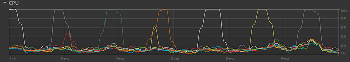

The spikes you see here are caused by the nextcloud client, when nothing is going on. I’m not using the computer and the sync is complete, files are not different from server, but this is the load of the client.
