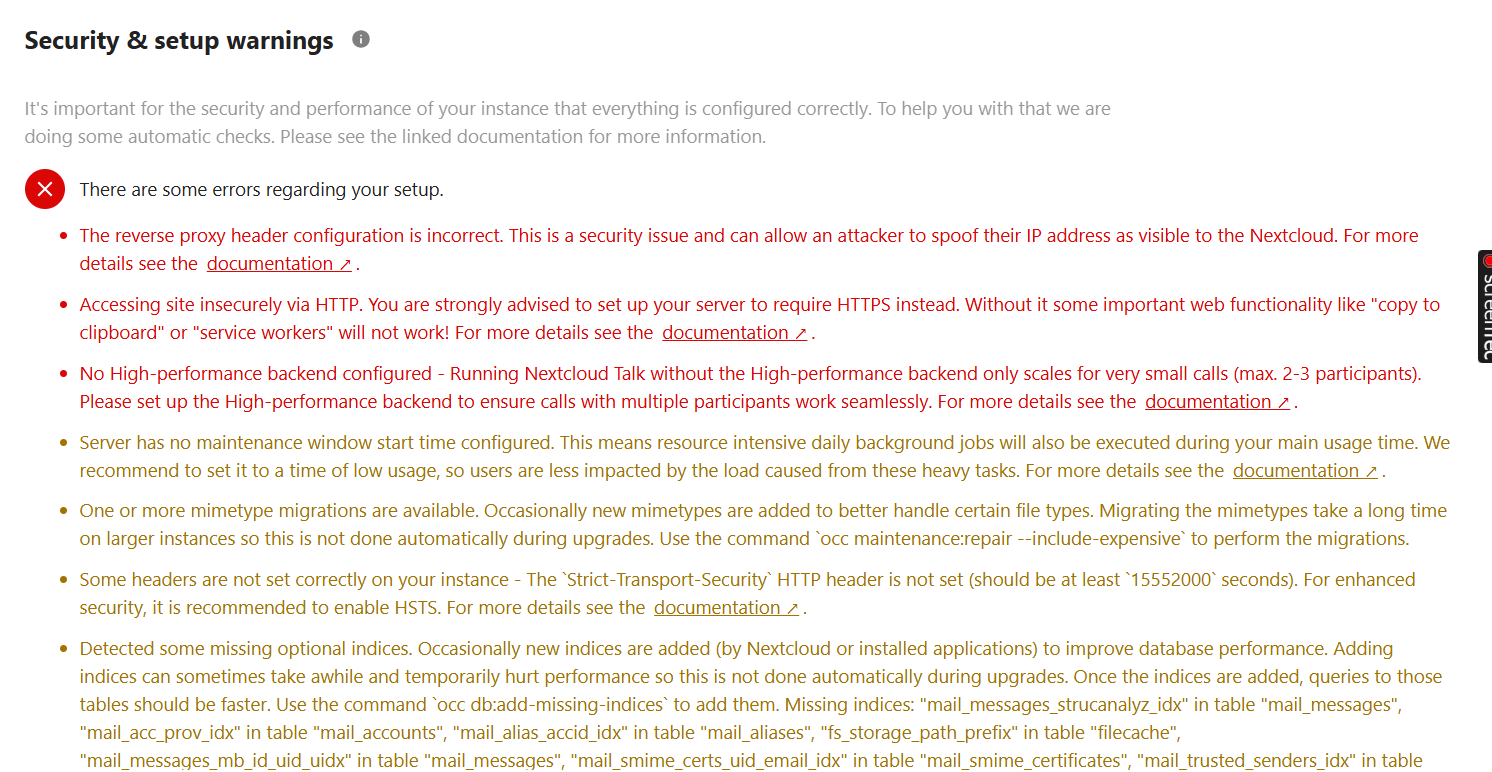

I got my Nextcloud set up, in my admin settings, under overview, I saw this message, image attached, what do I do?
Your screenshot shows several basic setup issues. That’s not unusual for a fresh install, but without proper info, it’s impossible to give you any real help.

Security & setup warnings
It’s important for the security and performance of your instance that everything is configured correctly. To help you with that we are doing some automatic checks. Please see the linked documentation for more information.
There are some errors regarding your setup.
  • The reverse proxy header configuration is incorrect. This is a security issue and can allow an attacker to spoof their IP address as visible to the Nextcloud. For more details see the documentation :up_right_arrow:.
  • Accessing site insecurely via HTTP. You are strongly advised to set up your server to require HTTPS instead. Without it some important web functionality like “copy to clipboard” or “service workers” will not work! For more details see the documentation :up_right_arrow:.
  • No High-performance backend configured - Running Nextcloud Talk without the High-performance backend only scales for very small calls (max. 2-3 participants). Please set up the High-performance backend to ensure calls with multiple participants work seamlessly. For more details see the documentation :up_right_arrow:.
  • Server has no maintenance window start time configured. This means resource intensive daily background jobs will also be executed during your main usage time. We recommend to set it to a time of low usage, so users are less impacted by the load caused from these heavy tasks. For more details see the documentation :up_right_arrow:.
  • One or more mimetype migrations are available. Occasionally new mimetypes are added to better handle certain file types. Migrating the mimetypes take a long time on larger instances so this is not done automatically during upgrades. Use the command occ maintenance:repair --include-expensive to perform the migrations.
  • Some headers are not set correctly on your instance - The Strict-Transport-Security HTTP header is not set (should be at least 15552000 seconds). For enhanced security, it is recommended to enable HSTS. For more details see the documentation :up_right_arrow:.
  • Detected some missing optional indices. Occasionally new indices are added (by Nextcloud or installed applications) to improve database performance. Adding indices can sometimes take awhile and temporarily hurt performance so this is not done automatically during upgrades. Once the indices are added, queries to those tables should be faster. Use the command occ db:add-missing-indices to add them. Missing indices: “mail_messages_strucanalyz_idx” in table “mail_messages”, “mail_acc_prov_idx” in table “mail_accounts”, “mail_alias_accid_idx” in table “mail_aliases”, “fs_storage_path_prefix” in table “filecache”, “mail_messages_mb_id_uid_uidx” in table “mail_messages”, “mail_smime_certs_uid_email_idx” in table “mail_smime_certificates”, “mail_trusted_senders_idx” in table “mail_trusted_senders”, “mail_coll_idx” in table “mail_coll_addresses”. For more details see the documentation :up_right_arrow:.
  • The PHP OPcache module is not properly configured. The OPcache buffer is nearly full. To assure that all scripts can be hold in cache, it is recommended to apply “opcache.memory_consumption” to your PHP configuration with a value higher than “128”.. For more details see the documentation :up_right_arrow:.

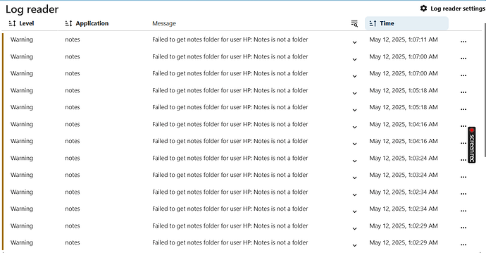

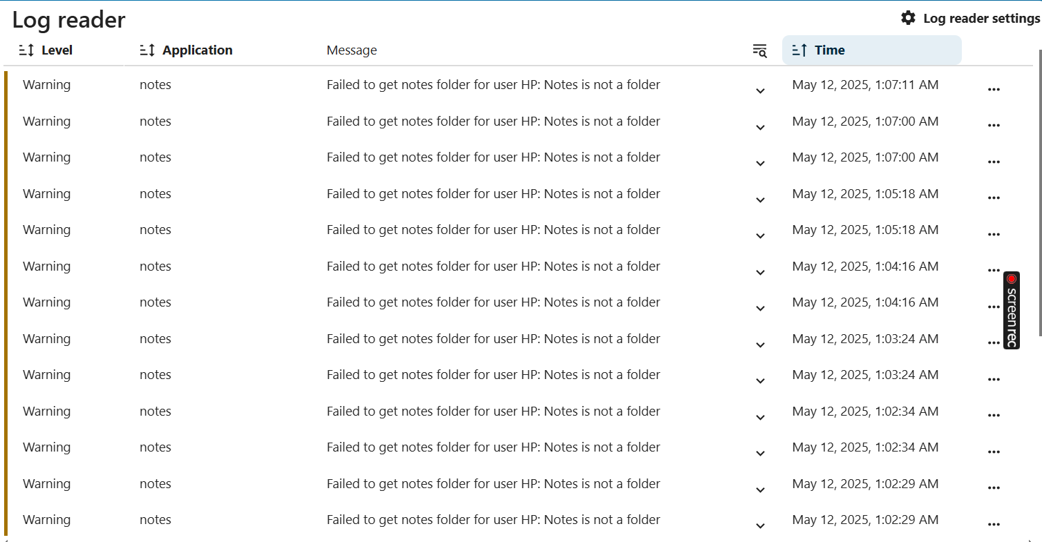

  • 11 warnings in the logs since May 7, 2025, 12:55:55 PM
  • The database is used for transactional file locking. To enhance performance, please configure memcache, if available. For more details see the documentation :up_right_arrow:.
  • Your installation has no default phone region set. This is required to validate phone numbers in the profile settings without a country code. To allow numbers without a country code, please add “default_phone_region” with the respective ISO 3166-1 code of the region to your config file. For more details see the documentation :up_right_arrow:.
  • You have not set or verified your email server configuration, yet. Please head over to the “Basic settings” in order to set them. Afterwards, use the “Send email” button below the form to verify your settings. For more details see the documentation :up_right_arrow:.

and what is your problem?
Is the error message just due to not being updated to the latest version - which is version 31.0.4 ?
this one? yes

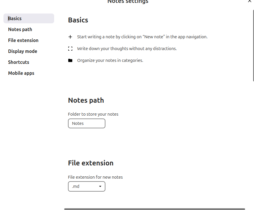

if you’d take a moment to read the warning message, it would be clear that there is a directory missing in your Nextcloud files directory.
grafik
so just add a directory Notes and behold the warning will disappear.
or configure a valid notes path:
First, set up https encryption. Then enable HSTS.
Those are IMHO the most important things you need to focus on now.
