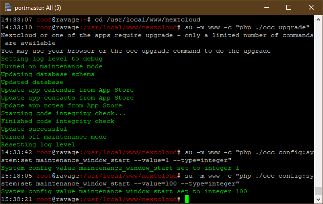

I took the above and tweaked it so it works on FreeBSD:
cd /usr/local/www/nextcloud
su -m www -c "php ./occ config:system:set maintenance_window_start --value=1 --type=integer"
Running that, I got the following in green:
System config value maintenance_window_start set to integer 1
And the error message went away. I didn’t even have to restart Apache or reboot :+1:
EDIT: @ernolf Thanks for the additional info! I’ve now changed my choice to 100 :slight_smile:
