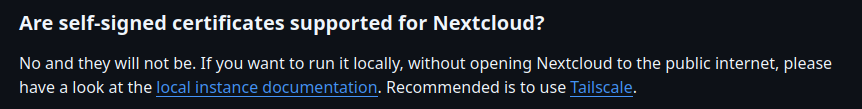

Hey @bender10 welcome to the nextcloud community :waving_hand:
yip… “no” is correct
grafik
Ah damnit, rtfm. :face_with_peeking_eye:
Thanks a lot for your fast response and that local-instance guide! I’ll check that and adjust my setup.
