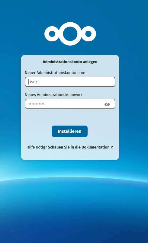

Proof that it works after the stack starts the first time:
Now I stop the stack via portainer
After starting the stack again, postgres displays this log
PostgreSQL Database directory appears to contain a database; Skipping initialization

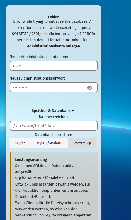

2025-04-28 19:17:11.978 UTC [44] ERROR:  permission denied for table oc_migrations
2025-04-28 19:17:11.978 UTC [44] STATEMENT:  SELECT "version" FROM "oc_migrations" WHERE "app" = $1 ORDER BY "version" ASC
This is what nextcloud displays in logs:
Previous: PDOException: SQLSTATE[42501]: Insufficient privilege: 7 ERROR:  permission denied for table oc_migrations
Trace: #0 /var/www/html/3rdparty/doctrine/dbal/src/Driver/PDO/Statement.php(130): PDOStatement->execute(NULL)
#1 /var/www/html/3rdparty/doctrine/dbal/src/Connection.php(1104): Doctrine\DBAL\Driver\PDO\Statement->execute()
#2 /var/www/html/lib/private/DB/Connection.php(419): Doctrine\DBAL\Connection->executeQuery('SELECT "version...', Array, Array, NULL)
#3 /var/www/html/lib/private/DB/ConnectionAdapter.php(50): OC\DB\Connection->executeQuery('SELECT "version...', Array, Array)
#4 /var/www/html/lib/private/DB/QueryBuilder/QueryBuilder.php(289): OC\DB\ConnectionAdapter->executeQuery('SELECT `version...', Array, Array)
#5 /var/www/html/lib/private/DB/MigrationService.php(173): OC\DB\QueryBuilder\QueryBuilder->executeQuery()
#6 /var/www/html/lib/private/DB/MigrationService.php(248): OC\DB\MigrationService->getMigratedVersions()
#7 /var/www/html/lib/private/DB/MigrationService.php(410): OC\DB\MigrationService->getMigrationsToExecute('latest')
#8 /var/www/html/lib/private/DB/MigrationService.php(387): OC\DB\MigrationService->migrateSchemaOnly('latest')
#9 /var/www/html/lib/private/Setup/AbstractDatabase.php(140): OC\DB\MigrationService->migrate('latest', true)
#10 /var/www/html/lib/private/Setup.php(319): OC\Setup\AbstractDatabase->runMigrations(NULL)
#11 /var/www/html/core/Command/Maintenance/Install.php(80): OC\Setup->install(Array, NULL)
#12 /var/www/html/3rdparty/symfony/console/Command/Command.php(326): OC\Core\Command\Maintenance\Install->execute(Object(Symfony\Component\Console\Input\ArgvInput), Object(Symfony\Component\Console\Output\ConsoleOutput))
#13 /var/www/html/3rdparty/symfony/console/Application.php(1078): Symfony\Component\Console\Command\Command->run(Object(Symfony\Component\Console\Input\ArgvInput), Object(Symfony\Component\Console\Output\ConsoleOutput))
#14 /var/www/html/3rdparty/symfony/console/Application.php(324): Symfony\Component\Console\Application->doRunCommand(Object(OC\Core\Command\Maintenance\Install), Object(Symfony\Component\Console\Input\ArgvInput), Object(Symfony\Component\Console\Output\ConsoleOutput))
#15 /var/www/html/3rdparty/symfony/console/Application.php(175): Symfony\Component\Console\Application->doRun(Object(Symfony\Component\Console\Input\ArgvInput), Object(Symfony\Component\Console\Output\ConsoleOutput))
#16 /var/www/html/lib/private/Console/Application.php(187): Symfony\Component\Console\Application->run(Object(Symfony\Component\Console\Input\ArgvInput), Object(Symfony\Component\Console\Output\ConsoleOutput))
#17 /var/www/html/console.php(87): OC\Console\Application->run(Object(Symfony\Component\Console\Input\ArgvInput))
#18 /var/www/html/occ(33): require_once('/var/www/html/c...')
#19 {main}
Retrying install...
After the container stops reinstalling and allows me to access the web page, I get this
I entered he postgres password below but it did not help, as I get back to the insallation screen you can see above.

This is what I got so far:
only starting the nextcloud service without cron / postgres / redis, I get into the installation screen in web. But even choosing sqlite, the data is not persisted. The db file but exists in my data folder on the server.
After setting up the volumes within docker compose correctly and creating the folders and files on the server correctly (at least I assume so (chown to test-nc and chmod to 777 testwise)), I am able to get thorugh the initial setup and the data folder and the postgres folder are filled.
Now I get this error:
Error while trying to initialise the database: An exception occurred while executing a query: SQLSTATE[42P07]:
Duplicate table: 7 ERROR:  relation "oc_migrations" already exists
