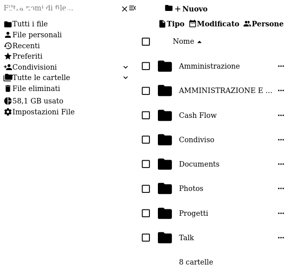

Pages in black and white
    • 29.0.12
    • OVH shared hosting
    • 8.2
    • yes
    • I think I have deleted some folders like data/appdata_*
Trying to free space, I think some folders have been deleted by mistake.
Now I have pages in black and white and not usable (cannot scroll page to get to content below the visibile screen)
I tried to get the folders from another NC install but it didn’t solve the issue.
I’ve also updated NC (it was 29.0.8 before).
Tried also maintenance:repair several time with no effect.
Any hint?
Thanks!!

tl:dr
Everything went back to normality
Short version:
I’m really not sure why, but changing php to phpcgi in .ovhconfig seems to be the soluton.
Long version:
In the first place, it turns out I’m not really aware what was the cause of it all. Initially I thought it was all due to the accidentally deleted appdata_ folder. So I tried to solve this by recreating the folder, running occ maintenance:repair several times, with apparently no luck.
Upgrading to NC 30 didn’t change the situation.
And since this error was due to the running out of space, I then thought that was also part of the problem. Deleting large files, purging the trash bin and file versions was the next step, with the same unsuccessful end.
Also, since I was changing the php version from 8.0, which was marked as unsuported, I also played a lot with this: 8.1, 8.2, 8.3 and even 8.4 (but NC complained about this to be too new and unsupported to).
At one point, while comparing settings with another NC installation that was still up and running, I noticed that in the .ovhconfig file the php engine wase indicated as phpcgi. I was a bit surprised, since from the OVh control panel that option had disappeared some time ago. So i just put this on my .ovhconfig file and boom! everything came back alive.
I have to say that I’m not 100% sure this was the solution, but I need to add that after a couple of days another NC instance turned to black and white. The first thing I did was to make the same change in .ovhconfig and it worked. Not only it’s working great, but I feel like it is faster then before.
A bit puzzling but in the end (for now) I’m backt to life!

I still have issues on this.
As a reminder, I am on a OVH shared hosting, php 8.2 . This is the .ovhconfig:
app.engine=phpcgi
container.image=stable64
app.engine.version=8.2
environment=production
http.firewall=none
With this setup, the online interface is OK. I do not experience any problem on the Linux site accessing files via webdav through gnome/nautilus .
But I still have a lot of issues when on a Windows pc accessing webdav share via mountain duck.
Often times, files are not uploaded, and this is a huge problem, as not only they are not there, but from that pc they seem to be created, but they are not. I’ve also tried the two different settings (smart and online).
It seems, but I need more evidence, that switching to php, instead of phpcgi, solves the issue. I got the idea from here:
But at the same time, the web interface gets b/w again :\
Any help appreciated!
Hello,
I had the same problem, on OVH too.
On the hosting of my customer, PHP was in 8.4 (for a CMS already installed)
As I have an other NextCloud instance on my own hosting provider (Infomaniak), I’ve tried to force install of v30.0.0, but it was not possible (PHP 8.3 max).
So I’ve found a solution by creating a .ovhconfig file in the folder where source files for NextCloud are stored.
In this file, I’ve let the value “app.engine=php” (and not phpcgi like suggested in an other topic : Nextcloud Displays White Screen on Desktop After Upgrade - #9 by Ulysse26 )
And I’ve only specified the PHP version in line “app.engine.version=8.3” instead of default “app.engine.version=8.4”
Now I’ve the CMS with PHP 8.4
And NextCloud with PHP 8.3
And no more “black and white unusable GUI” of NextCloud !
The behavior of ovh in this case is very inconsistent. It worked for me with phpcgi and not with php, but after some time I had to revert back to php…
Be aware that if you put a .ovhconfig in your nextcloud folder, the next attempt to upgrade will not be successful because it identifies the file as “alien” and will not go forward until you remove it form the folder…
