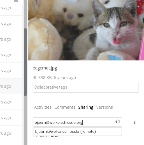

Also you can use not one but two or more different Nextclouds. You can manage them in one Nextcloud app and also you can use e.g. federation (docs). I use a lot of different Nextclouds. I have distributed the data in such a way that I rather do not have to exchange data between the Nextclouds. E.g. photos only on one of the Nextclouds. Normal data on another Nextcloud.
