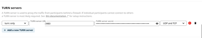

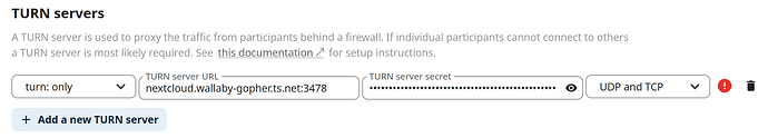

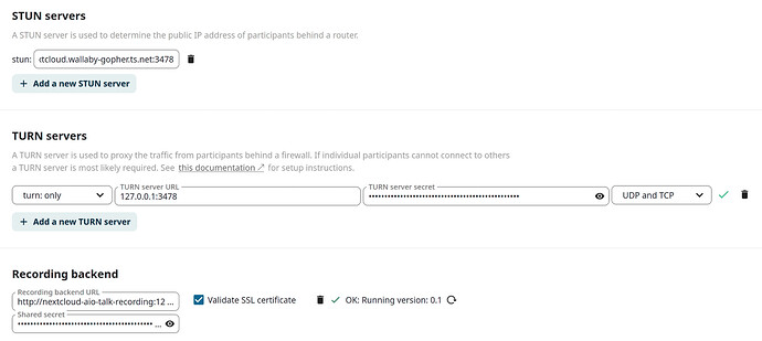

Custom TURN server configured: no, turn:only UDP/TCP, only server showing unhealthy
Custom STUN server configured: no, nextcloud.wallaby-gopher.ts.net:3478

The issue you are facing:
Hello, I am having an issue where nextcloud talk works perfectly on the the same wifi, but as soon as they’re not, it never loads. Technically talk instances should always be seen as on the same wifi due to my tailscale routing method so TURN should not be necessary. I tried removing the TURN server due to an error, but it comes right back.
Is this the first time you’ve seen this error? (N): I think it is related to my cannot create shared album issue here: https://help.nextcloud.com/t/cannot-create-shared-albums-or-share-prexisting-albums/212635
Steps to replicate it:
  1. Make a talk call to a remote location, even with strong connection.
  2. Both Parties see the other as muted and loading, forever.
  3. Sometimes one party will ‘drop’ and stop loading but they are not actually connected.

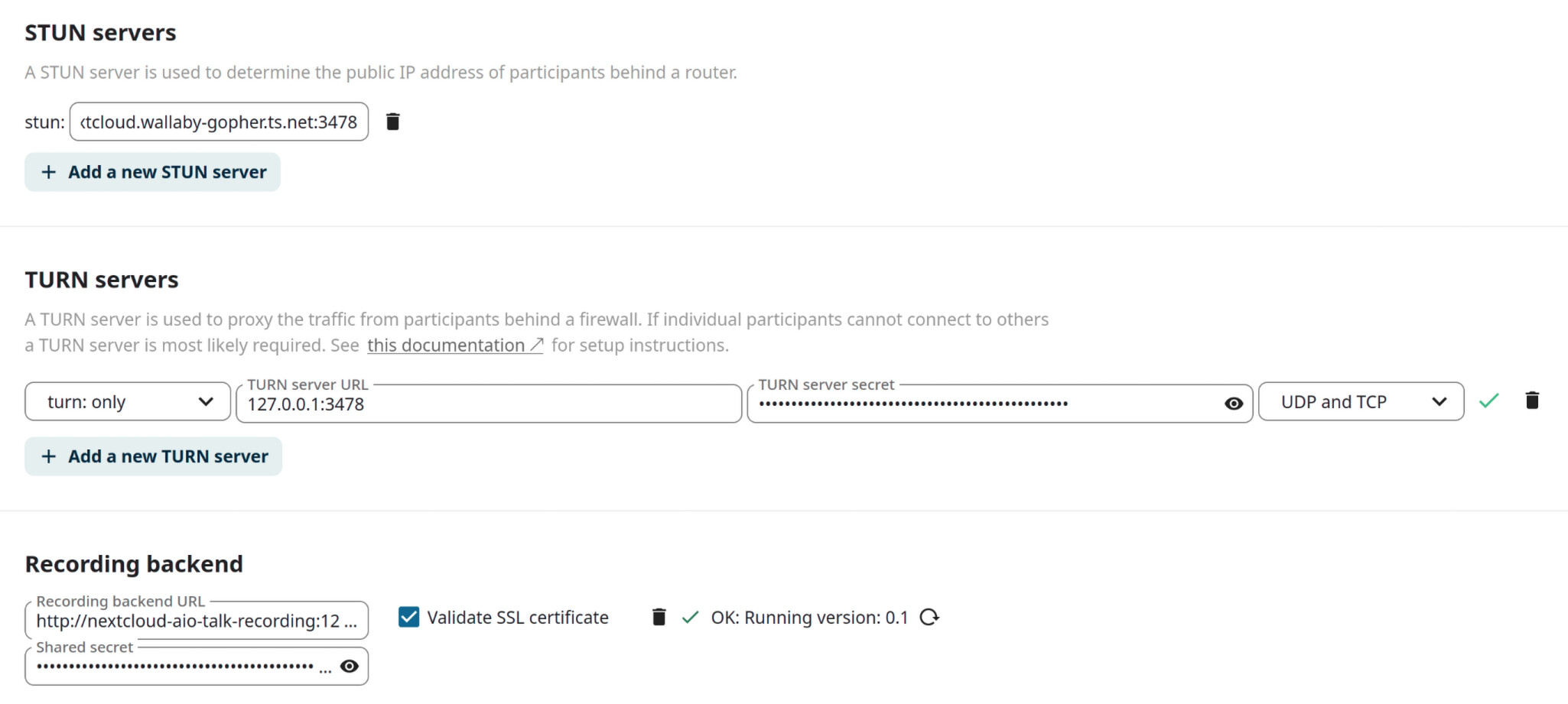

Error I didn’t get but the call receiver did about TURN:
Could not establish a connection with at least one participant. A TURN server might be needed for your scenario. Please ask your administrator to set one up.
This exactly the proof TURN is required. Trust my many years experience in VOIP systems - there almost no scenario when you don’t need TURN… and to be honest why should avoid using it?
Oh, I have 0 years experience :joy: I read they open a lot of ports and are insecure because of that. Could you offer some guidance on how to open one in a contained environment?
this is a common misconception - the application is not more or less secure just because it opens many ports.
TURN is not about isolating system - it the complete opposite it connects users through firewalls. Many tutorials exist - just keep in mind don’t do any security voodoo - TURN requires straight connection without NAT, firewall reverse proxy etc.

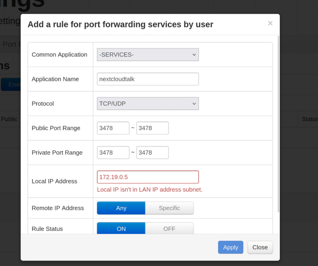

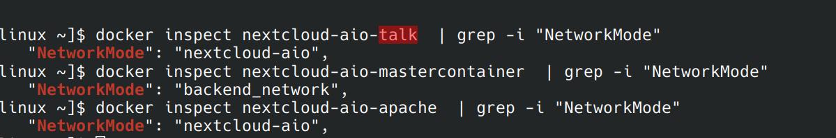

Okay, coming back to this after being busy for a while, apparently nextcloud AIO-talk comes bundled with coturn already (hence the prepopulated turn server, although unfortunately after recently deleting it’s not coming back). That said, it wasn’t working. I’m having trouble finding documentation on how to use the existing TURN server, especially with my tailscale-caddy configuration. Can you steer me in the right path? I notice in the talk log it mentions there’s no trusted proxies but I’m not sure how to add those.
Exec: /opt/eturnal/erts-15.1.2/bin/erlexec -noinput +Bd -boot /opt/eturnal/releases/1.12.1/start -mode embedded -boot_var SYSTEM_LIB_DIR /opt/eturnal/lib -config /opt/eturnal/releases/1.12.1/sys.config -args_file /opt/eturnal/releases/1.12.1/vm.args -erl_epmd_port 3470 -start_epmd false -- foreground
Root: /opt/eturnal
/opt/eturnal

while details can be tricky general mechanics are simple - TURN server must be reachable (and from my experience it should be excluded from voodoo things like VPN and security snakeoil) - as this components works as relay for clients which can not connect to each other.
I found pretty cool architecture drawing which explains the use of TURN very well
or maybe this references:
So far in my self-hosting journey I have only engaged in vpn tomfoolery :skull_and_crossbones:
I think because nextcloud was reverse proxied then the domain these articles want would be no good? (I got back the turn server by restarting in the :8080 port)
is there a way to expose the AIO turn server to the internet otherwise? Something like ddns-updater (to deal with the server machine’s unavoidable dynamic IP) to a domain I purchased (not sure about settings on the Porkbun side) that I’m not sure how to point to the AIO-talk without reverse proxying. For reference I had already tried using the metered free TURN but got stuck beyond hitting in the domain/secret because there was nowhere to enter the API that I think was necessary. Thank you for your help, this is new territory for me.
the answer is: “no reverse proxy at all”. each client must have direct connection to the TURN server - in SOHO environment this more or less always direct port forwarding. one can not reverse proxy TURN protocol (media like voice and video in general)

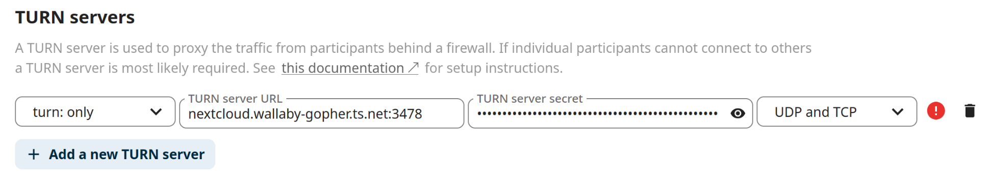

Okay so as I was working on port forwarding I check that the IP/port is correct on the host and it only shows service as stun and tcp, is that the problem, AIO-talk isn’t actually making the TURN?
$ nmap -p 3478 0.0.0.0
Starting Nmap 7.95 ( https://nmap.org ) at 2025-06-11 08:56 CDT
Nmap scan report for 0.0.0.0
Host is up (0.000066s latency).
PORT     STATE SERVICE
3478/tcp open  stun
Nmap done: 1 IP address (1 host up) scanned in 0.02 seconds
Anyway, I don’t think I’m port forwarding right, I got the nextcloud talk local ip here
$ docker exec -it nextcloud-aio-talk sh
/ $ ip addr show
1: lo: <LOOPBACK,UP,LOWER_UP> mtu 65536 qdisc noqueue state UNKNOWN qlen 1000
    link/loopback 00:00:00:00:00:00 brd 00:00:00:00:00:00
    inet 127.0.0.1/8 scope host lo
       valid_lft forever preferred_lft forever
    inet6 ::1/128 scope host
2: eth0@if28: <BROADCAST,MULTICAST,UP,LOWER_UP,M-DOWN> mtu 1500 qdisc noqueue state UP
    link/ether 3e:d0:8a:a0:a0:a1 brd ff:ff:ff:ff:ff:ff
    inet 172.19.0.5/16 brd 172.19.255.255 scope global eth0
But it won’t accept it
It took the host pc’s address but the turn continues to not connect which I think may be because the TURN isn’t started at all as above
IMO AiO runs integrated TRUN server.. you should see it running docker ps - open ports are listed there.
Please look at How to debug problems with Collabora and/or Talk · nextcloud/all-in-one · Discussion #1358 · GitHub as well.
Okay so following @szaimen’s steps
it didn’t get into hosts

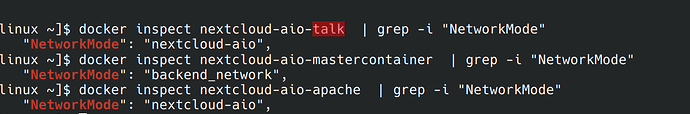

I was thinking about how recently the docker default network stopped working and I had to start adding my own and look at this:
but it still seems to have not added that network, strangely. Possibly it’s not meant to,
especially because it broke the connection with collabora so that it hangs
so I had to remove nextcloud-aio from the mastercontainer again.

AIO in home network behind reverse proxy
look at this picture - it should visualize the connections little better - adopt to your tailscale setup
it looks little different if your reverse proxy is in docker as well - then you should create a common network and send traffic to apache container using APACHE_ADDITIONAL_NETWORKvariable
flowchart LR
  internet-->fritz.box
   fritz.box(router);
   subgraph intLAN[home network]
                        fritz.box-- port-forward<br>tcp/80<br>tcp/443 -->RP;
			RP[reverse proxy<br>https:\//your-nc-domain.com]
			subgraph docker
				master[mastercontainer<br><br>https\://internal.ip.address.of.server:8080:<br>AIO-interface with self-signed cert];
				NC[APACHE_PORT<br>:11000];
				TALK[TALK_PORT<br>tcp/3478<br>udp/3478];
			end
			management[user]-- local -->master
		end
		RP--http-->NC
		fritz.box--port forward<br>tcp/3478<br>udp/3478-->TALK
I think for the layman they had might as well be synonymous because they’ve been abstracted into a single talk container. Along those lines is the diagram also incorrect because it shows talk port entirely separate from mastercontainer when it is launching that server, or is NO internal traffic possible and it HAS to exit and go through the router to pass traffic between and the TURN inside nextcloud-aio-talk?
Okay so with that in mind I added the network I span between containers ‘backend_network’ to nextcloud:

again it did not break anything like it had previously (yey!)
and now we get a green check when I manually add this to TURN
how do I check the health of STUN? There’s no checkmark?
Also, unfortunately, non connection continues when not on the same network and now I have noticed voice calls fail regardless, but plenty of logs that I hope you may understand?

setting TURN to 127.0.0.1 lead you to nowhere. This host/ip must be reachable from every client - which is obviously not the case for localhost.
I wasn’t getting anywhere with nextcloud’s built-in talk, so I thought I’d try spinning up eturnal. I am able to reach it with turn:[machine’s public ip]:port via (Trickle ICE):
but nextcloud remains obstinately unconnected.
