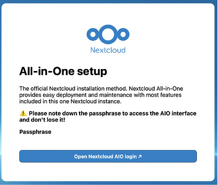

Was heißt das: “Please type the domain that will be used for Nextcloud below in order to create a new AIO instance.”
Ist das die öffentliche Adresse wie DynDNS o.ä.?
Nein, eine Domain ist so etwas wie z.B. nextcloud.com. Also das hier (Domain in Capslock): https://NEXTCLOUD.COM/

Ach ja, eben alle Container gelöscht und frisch installiert, jetzt kommt folgendes: `root@debian:~# sudo docker run \
–sig-proxy=false
–name nextcloud-aio-mastercontainer
–restart always
–publish 80:80
–publish 8080:8080
–publish 8443:8443
–volume nextcloud_aio_mastercontainer:/mnt/docker-aio-config
–volume /var/run/docker.sock:/var/run/docker.sock:ro
nextcloud/all-in-one:latest
Trying to fix docker.sock permissions internally…
Creating docker group internally with id 995
WARNING: No swap limit support
Initial startup of Nextcloud All-in-One complete!
You should be able to open the Nextcloud AIO Interface now on port 8080 of this server!
E.g. https://internal.ip.of.this.server:8080 Important: do always use an ip-address if you access this port and not a domain as HSTS might block access to it later!
If your server has port 80 and 8443 open and you point a domain to your server, you can get a valid certificate automatically by opening the Nextcloud AIO Interface via: https://your-domain-that-points-to-this-server.tld:8443
{“level”:“info”,“ts”:1726835716.124021,“msg”:“using config from file”,“file”:“/Caddyfile”}
{“level”:“info”,“ts”:1726835716.1262255,“msg”:“adapted config to JSON”,“adapter”:“caddyfile”}
[Fri Sep 20 12:35:16.141856 2024] [mpm_event:notice] [pid 140:tid 140] AH00489: Apache/2.4.62 (Unix) OpenSSL/3.3.2 configured – resuming normal operations
[Fri Sep 20 12:35:16.141910 2024] [core:notice] [pid 140:tid 140] AH00094: Command line: ‘httpd -D FOREGROUND’
[20-Sep-2024 12:35:16] NOTICE: fpm is running, pid 145
[20-Sep-2024 12:35:16] NOTICE: ready to handle connections
Bad packet length 1246483995.
ssh_dispatch_run_fatal: Connection to 192.168.178.61 port 22: Connection corrupted`.
Komme wieder nicht auf das WebInterface. Wo kommt denn jetzt plötzlich der Port 22 her? sollte das nicht 8080 sein?
