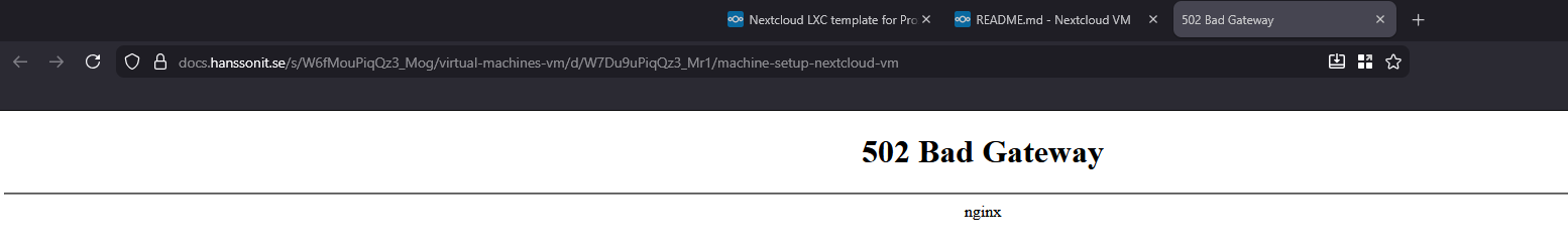

Thank you for sharing this. I went ahead and deleted my existing nextcloud instance for this, downloaded the 500 GB version but when viewing the installation guide I get this message:
Would you have the installation guide? Thanks!
