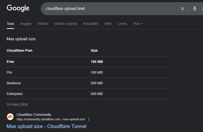

This may be the beginning of a diagnosis, I encountered this error 2 years ago. Cloudflare limits its speeds depending on the type of your subscription
I deduce that if your NC server uses the ClouFlare DNS that you normally modify at your registrar, in addition to having registered your FQDN with ClouFlare, I think that you are subject to their limits.

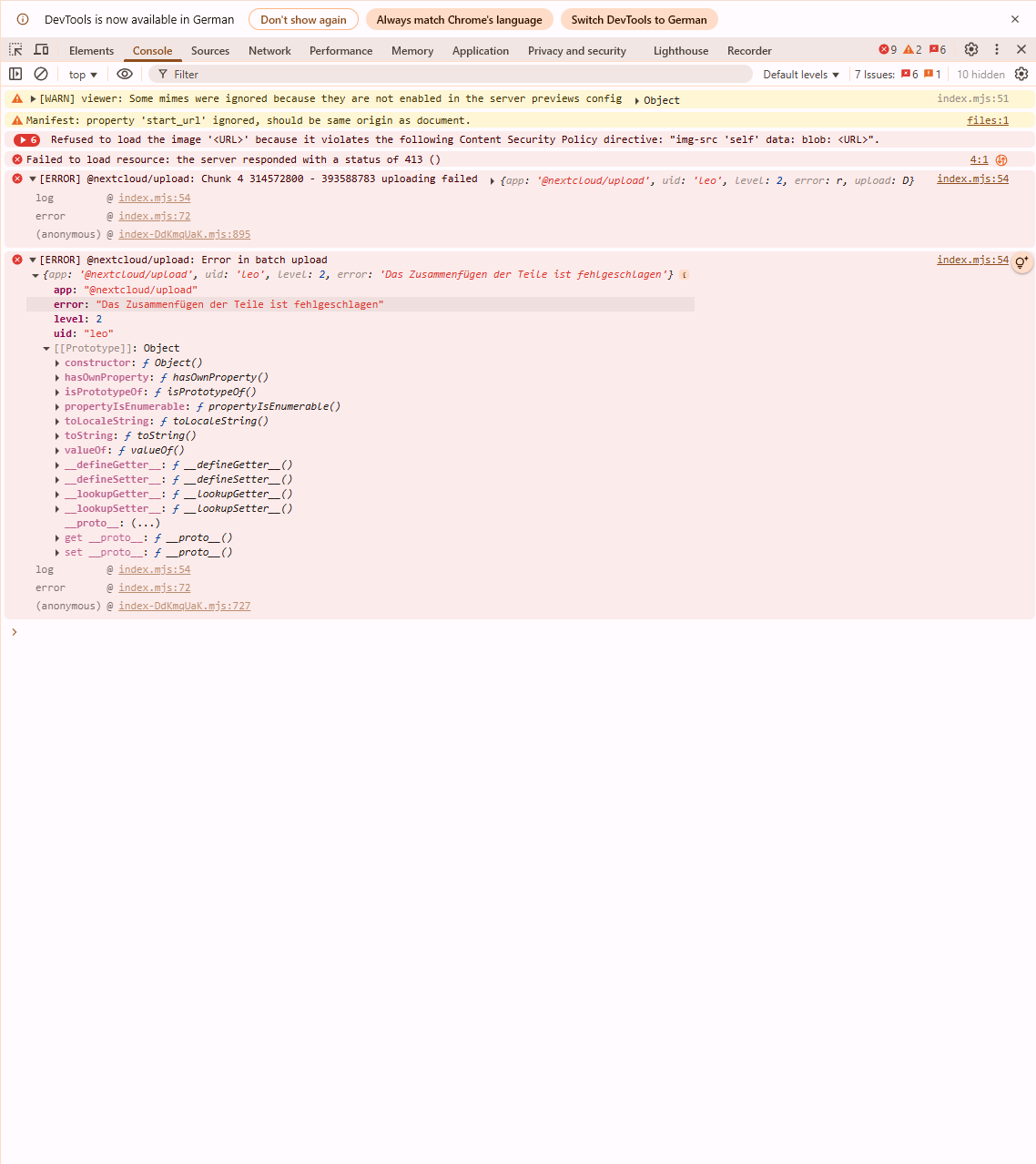

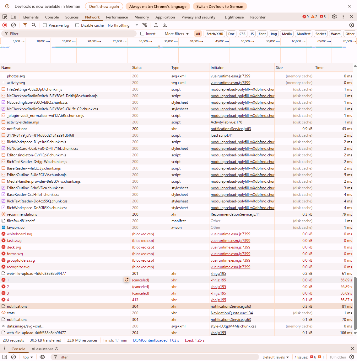

Then I reproduced the error and took screenshots of the logs from Chrome DevTools.
