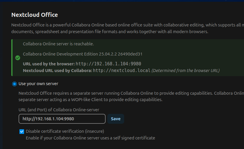

On my local machine, I’m running Collabora Online (master branch with the latest patches), and it’s running fine on its own.

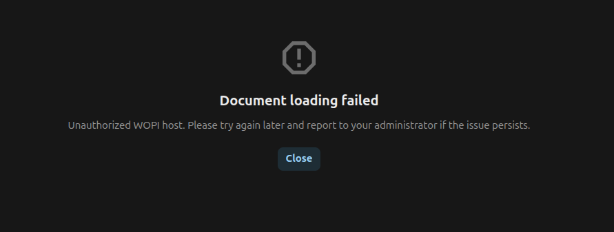

After configuring the Collabora URL in Nextcloud, I see the green message indicating that the server is reachable. However, when I try to open any document, I get this error:
“Unauthorized WOPI host. Please try again later and report to your administrator if the issue persists.”

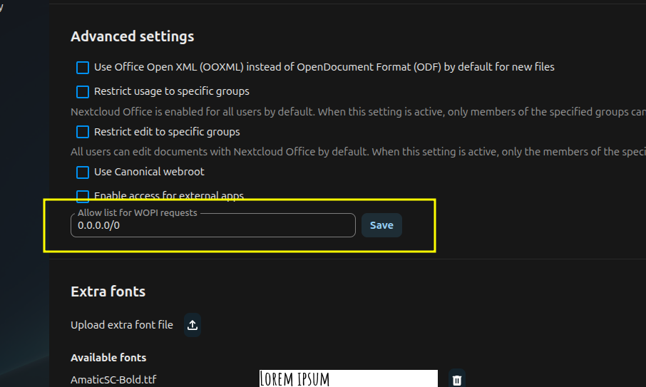

Unauthorized WOPI hosts comes from the wopi_allowlist which creates an ip-based list of hosts allowed to send WOPI requests to Nextcloud. as you are running a dev environment I think adding “allow all” rule like 0.0.0.0/0 should fix the problem
look at our source of truth Collabora integration guide - it doesn’t cover your dev case but maybe it helps you as well.
Hii @wwe Thanks for the quick reply. I have tried to add the Ip you suggested in my NC dev environment but still the issue is same.

From CODE troubleshooting list I see
curl -i https://localhost:9980/hosting/wopiAccessCheck --header “Content-Type: application/json” -d '{“callbackUrl”:“https://wopi-host.local:8443”}
AFAIK CODE exposes https on port 9980 - but you seem to configure plain http..
as scubamuc mentioned - TLS is required for productive installations - I’m not sure there are additional settings required to setup dev without TLS - I never tried.. I’m aware of issues e.g. with copy&paste which doesn’t work without TLS. Depending on your goal it might be easier to setup a production-like environment with DNS/TLS rather some hand-crafted special which might work completely different..
