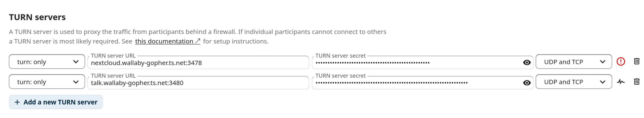

The issue you are facing:
The nextcloud talk turn is not healthy, calls will not connect off of local network.

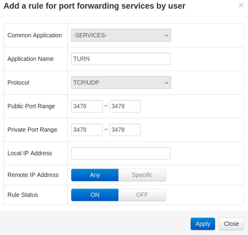

Port forward, local ip found with “ip addr show | grep enp5s0” and using the inet using syntax XXX.XXX.X.XX

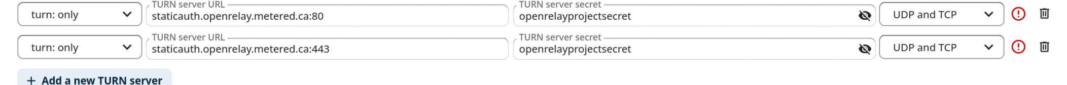

use paid service e.g. Free WebRTC TURN Server - Open Relay Project | Open Relay Project - Free WebRTC TURN Server

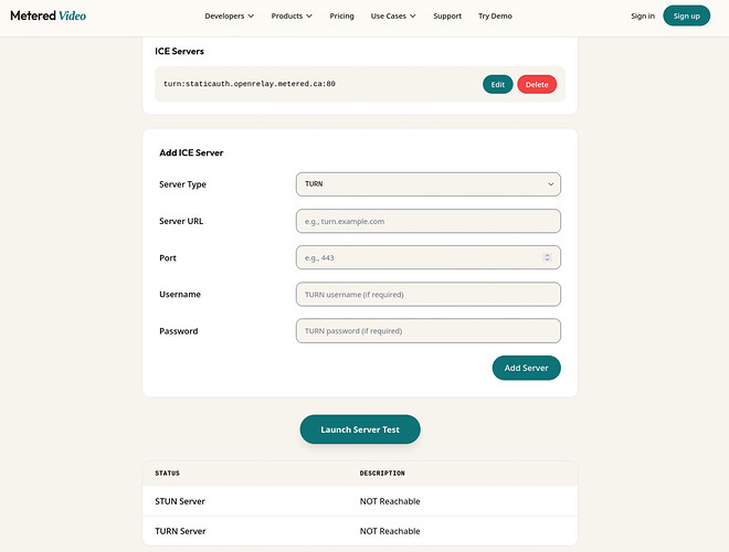

I followed their very simple setup, and it still doesn’t work
Are they still offering this service? I have the account and everything (but talk doesn’t have anywhere to input the credentials?)
That said, I can’t even ping it from my host.

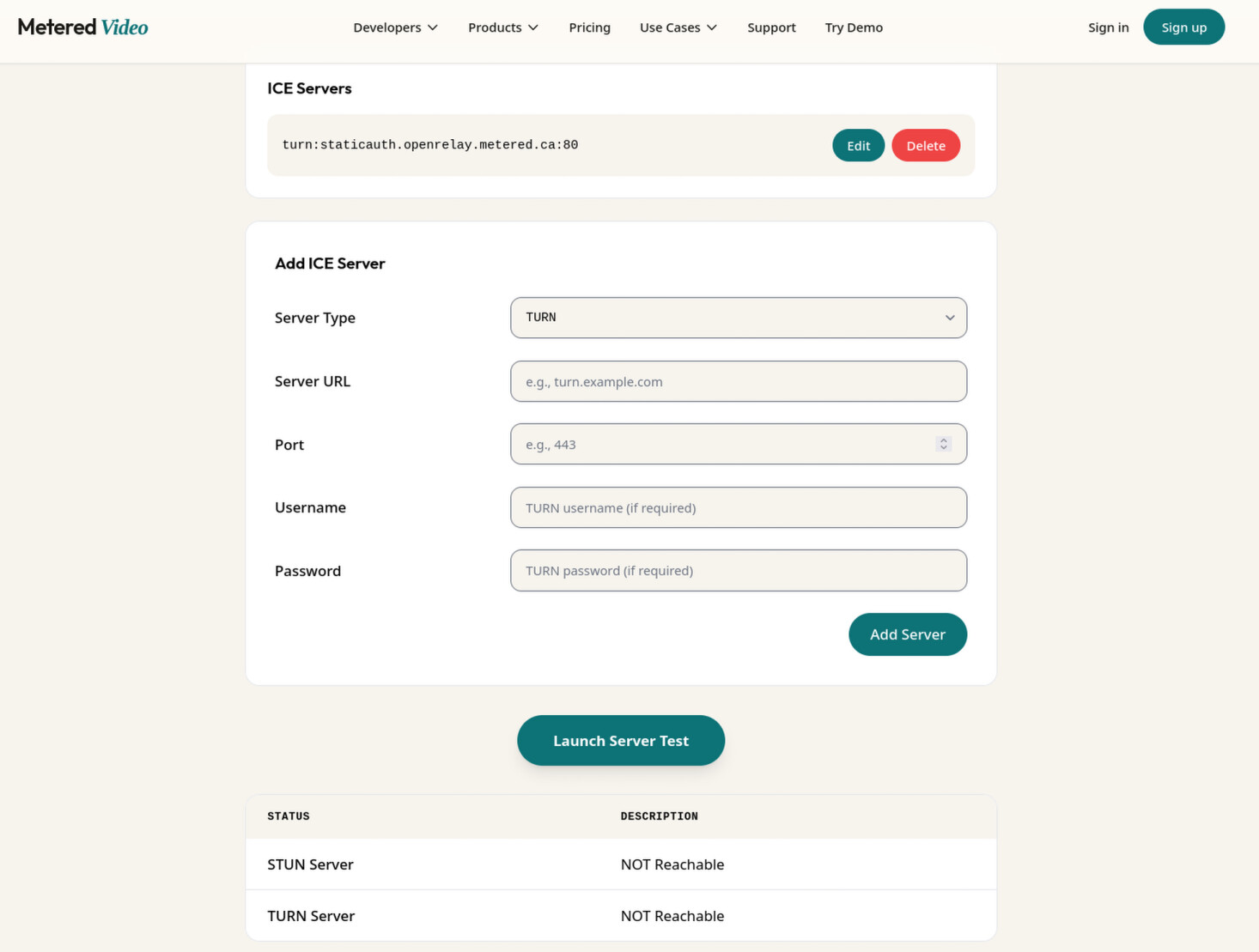

$ ping staticauth.openrelay.metered.ca
PING staticauth.openrelay.metered.ca (216.39.253.123) 56(84) bytes of data.
From 38.17.20.195 icmp_seq=1 Destination Host Unreachable
^C
--- staticauth.openrelay.metered.ca ping statistics ---
4 packets transmitted, 0 received, +1 errors, 100% packet loss, time 3054ms
[drm@archlinux ~]$ ping $ ping staticauth.openrelay.metered.ca
^C
running a traceroute (with the first few hops removed) shows it dies at their door, not a me problem, I think.
$ traceroute 216.39.253.123
traceroute to 216.39.253.123 (216.39.253.123), 30 hops max, 60 byte packets
 8  * * be3018.ccr41.ord03.atlas.cogentco.com (154.54.12.81)  20.813 ms
 9  be2765.ccr41.ord01.atlas.cogentco.com (154.54.45.17)  20.955 ms be2766.ccr42.ord01.atlas.cogentco.com (154.54.46.177)  19.229 ms  25.170 ms
10  port-channel2717.ccr91.cle04.atlas.cogentco.com (154.54.6.222)  27.270 ms port-channel2718.ccr92.cle04.atlas.cogentco.com (154.54.7.130)  28.835 ms port-channel2717.ccr91.cle04.atlas.cogentco.com (154.54.6
.222)  30.404 ms
11  be2994.ccr32.yyz02.atlas.cogentco.com (154.54.31.234)  32.126 ms be2993.ccr31.yyz02.atlas.cogentco.com (154.54.31.226)  34.195 ms be2994.ccr32.yyz02.atlas.cogentco.com (154.54.31.234)  24.533 ms
12  be2055.rcr51.yyz04.atlas.cogentco.com (154.54.81.42)  28.535 ms  36.072 ms  34.512 ms
13  te0-0-2-0.nr11.b011274-1.yyz04.atlas.cogentco.com (154.24.52.178)  27.615 ms te0-0-2-0.nr12.b011274-1.yyz04.atlas.cogentco.com (154.24.54.90)  29.172 ms te0-0-2-0.nr11.b011274-1.yyz04.atlas.cogentco.com (1
54.24.52.178)  34.210 ms
14  38.17.20.195 (38.17.20.195)  32.420 ms 38.17.20.165 (38.17.20.165)  30.739 ms  34.163 ms
15  * * *
16  * * *
17  * * *
18  * * *
19  38.17.20.165 (38.17.20.165)  32.203 ms !H * *
It seems their own test tool fails it as well (this does allow the credentials):
I have experience with their service as my own TURN works well, but port 80 and 443 sound wrong for me. → 80 and 443 are right according to their manual.. :thinking: well no idea.. reach out to the project or look for an alternative - there are more services like this… but at the end you still need a direct connection to TURN server (maybe not the case with your tailscale setup) otherwise calls will suffer.
I’m not sure what are drawbacks if you clients can connect to TURN and server not.. maybe it will work well for small calls without HPB
I’ll reach out to them.

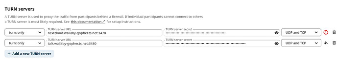

In the meantime, would you mind sharing your TURN setup? I’ve tried with eturnal below but with no success.
networks:
  bridge_network:
    external: true
  backend_network:
    external: true
  nextcloud-aio:
    external: true
services:
  #for nextcloud talk to work outside of network
  eturnal:
    image: ghcr.io/processone/eturnal:latest
    networks:
      - backend_network
      - nextcloud-aio
    hostname: eturnal
    container_name: eturnal
    restart: unless-stopped
    user: 9000:9000
    ### security options
    read_only: true
    cap_drop:
      - ALL
    cap_add:
      - NET_BIND_SERVICE
    ### Note: if eturnal binds to privileged ports (<1024) directly, the option "security_opt" below must be commented out.
    security_opt:
      - no-new-privileges:true
    ### networking options
    ports:
      - 3480:3480     # STUN/TURN non-TLS | 3478 already in use by nextcloud backend?
      - 3480:3480/udp # STUN/TURN non-TLS | 3478 already in use by nextcloud backend?
       #- 5349:5349   # STUN/TURN TLS
      - 50000-50500:50000-50500/udp # TURN relay range
    #network_mode: "host"
    ### Environment variables - information on https://eturnal.net/doc/#Environment_Variables
    environment:
      - ETURNAL_RELAY_MIN_PORT=50000
      - ETURNAL_RELAY_MAX_PORT=50500
      - STUN_SERVICE=false #"nextcloud.wallaby-gopher.ts.net 3478" #:3478 #port already assumed? they use a space here https://eturnal.net/doc/container.html
    volumes:
      - /media/server/server/turn/eturnal.yml:/etc/eturnal.yml:ro
eturnal:
  ## Shared secret for deriving temporary TURN credentials (default: $RANDOM):
  secret: "snip"     # Shared secret
  ## The server's public IPv4 address (default: autodetected):
  #relay_ipv4_addr: "XXX.XX.XX.XX" #confidential!! Might change? Will VPN break?
  ## The server's public IPv6 address (optional):
  #relay_ipv6_addr: "2001:db8::4"
  listen:
      ip: "::"
      port: 3480
      transport: udp
      ip: "::"
      port: 3480
      transport: tcp

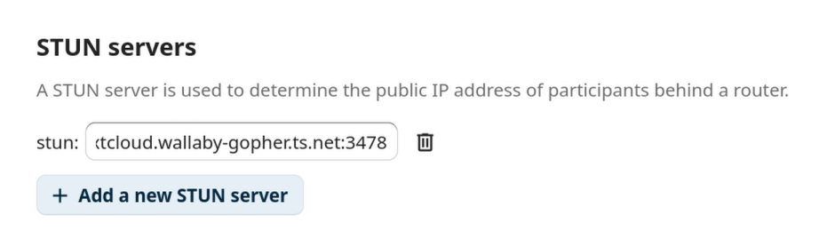

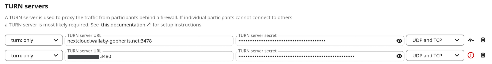

Its stun server is also having trouble, the default does not connect:
Cannot query stun.conversations.im:3478: network is unreachable
so I tried stetting it to nextcloud’s stun:
Cannot query "nextcloud.wallaby-gopher.ts.net:3478": non-existing domain

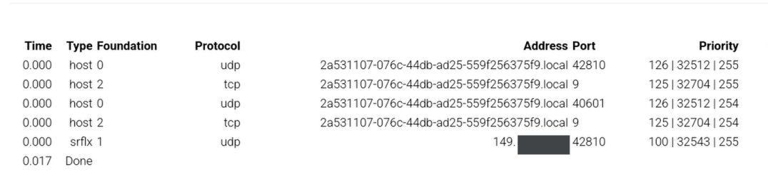

I don’t get an error in logs when I manually grab my external ip (not optimal obviously) and set it in the .yml
and use the following command to find that ip: curl -s http://tnx.nl/ip
relay_ipv4_addr: "XXX.XX.XXX.XX"
as far as the port forward settings, I’m confused are 50000:50500 supposed to be the public range or 3480:3480? Also just checking, the ip address in nextcloud should be the same one I used in the relay, right?
I don’t get this. nextcloud’s STUN obviously doesn’t run your ..ts.net domain? be aware STUN and TURN are often mentioned together but both are completely different techniques
  • STUN only tells you about external IP which your connection exposes (if you are lucky your firewall allow inbound connections for each open outbound connection)

Port forward from public IP/interface to :3478 tcp and udp (but udp is most important). 50000k range is optional but if you can afford to open is it allows more different media path and potentially faster connects.

That’s what it set itself as. I also tried adding the coturn server since it also runs a STUN. I test that below on the host machine.

so 3478 and 50000k should be entirely separate port forward inputs?
I can connect from the host with just 3478 port forward but I still get a red checkmark in nextcloud and calls do not work off of network

Sorry for the confusion, I’ve been using different ports for tests.
Nextcloud’s built in TURN uses the standard 3478, eturnal I set to 3480, and coturn to 3481.
Using trickle ice I can test STUN off network successfully, but TURN asks for a user which isn’t compatible with nextcloud’s secret style, so I’m not sure how to test that. I think if STUN is reachable like this surely TURN would be accessible off network as well?
I can get a green checkmark within nextcloud on the hostmachine using my host’s local ip but obviously that’s incorrect for other clients, but I think it shows that nextcloud IS able to reach coturn and It just doesn’t want to route through the public IP?
Interestingly, running the test from another device shows it CAN reach out, it’s just unauthorized? I notice it’s the device’s tailscale ip address, 100.88.23.57:35608, not it’s actual ip address. This remote value is usually the host’s external ip when I run the turnutil’s test.

from: How to test online whether a STUN/TURN server is working properly or not | Our Code World
Rule of thumb
You can easily determine if your server works with both tools or with your own JavaScript:
  • A STUN server works if you can gather a candidate with type "srflx".
  • A TURN server works if you can gather a candidate with type "relay".

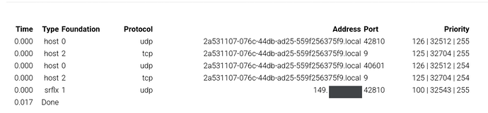

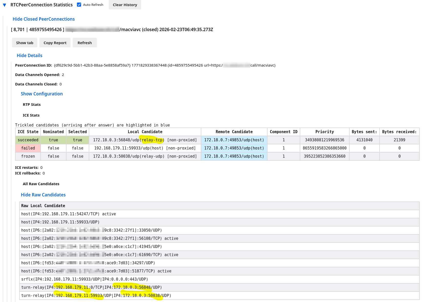

in firefox in an about:webrtc in running Talk call I see candidates like this
  • 192.168.179.11 is the local IP of my client
  • 172.. is obviously a docker IP - it looks it reflects the docker internal IP connecting to turn server, I’m surprised it doesn’t show any public IP there..
  • review relay candidates coming from a TURN server
in the log I see (there is much more - lot of errors as well - search for “turn” tosee relevant entries)
such a process repeats many time for each possible IP/port combination
browser webrtc log
ICE(PC:{df629c9d-5bb1-42b3-88aa-5e8858af59a7} 1771829338367448 (id=4859755495426 url=https://nc.mydomain.tld/call/macviavc)): peer (PC:{df629c9d-5bb1-42b3-88aa-5e8858af59a7} 1771829338367448 (id=4859755495426 url=https://nc.mydomain.tld/call/macviavc):default) pairing local trickle ICE candidate srflx(IP4:192.168.179.11:59933/UDP|IP4:0.0.0.0:443/UDP)
ICE(PC:{df629c9d-5bb1-42b3-88aa-5e8858af59a7} 1771829338367448 (id=4859755495426 url=https://nc.mydomain.tld/call/macviavc)): peer (PC:{df629c9d-5bb1-42b3-88aa-5e8858af59a7} 1771829338367448 (id=4859755495426 url=https://nc.mydomain.tld/call/macviavc):default) starting grace period timer for 5000 ms
Unrecognized attribute: 0x802b
Unrecognized attribute: 0x802c
STUN-CLIENT(srflx(IP4:192.168.179.11:51530/UDP|IP4:0.0.0.0:443/UDP)): Received response; processing
ICE(PC:{df629c9d-5bb1-42b3-88aa-5e8858af59a7} 1771829338367448 (id=4859755495426 url=https://nc.mydomain.tld/call/macviavc)): peer (PC:{df629c9d-5bb1-42b3-88aa-5e8858af59a7} 1771829338367448 (id=4859755495426 url=https://nc.mydomain.tld/call/macviavc):default) pairing local trickle ICE candidate srflx(IP4:192.168.179.11:51530/UDP|IP4:0.0.0.0:443/UDP)
Inconsistent message method: 113 expected 001
STUN-CLIENT(relay(IP4:192.168.179.11:59933/UDP|IP4:0.0.0.0:3478/UDP)::TURN): Received response; processing
STUN-CLIENT(relay(IP4:192.168.179.11:59933/UDP|IP4:0.0.0.0:3478/UDP)::TURN): nr_stun_process_error_response failed
STUN-CLIENT(relay(IP4:192.168.179.11:59933/UDP|IP4:0.0.0.0:3478/UDP)::TURN): Error processing response: Retry may be possible, stun error code 401.
STUN-CLIENT(relay(IP4:192.168.179.11:51530/UDP|IP4:0.0.0.0:3478/UDP)::TURN): Received response; processing
STUN-CLIENT(relay(IP4:192.168.179.11:51530/UDP|IP4:0.0.0.0:3478/UDP)::TURN): nr_stun_process_error_response failed
STUN-CLIENT(relay(IP4:192.168.179.11:51530/UDP|IP4:0.0.0.0:3478/UDP)::TURN): Error processing response: Retry may be possible, stun error code 401.
Inconsistent message method: 103 expected 001
TURN(relay(IP4:192.168.179.11:59933/UDP|IP4:0.0.0.0:3478/UDP)): Succesfully allocated addr IP4:172.18.0.3:50038/UDP lifetime=3600
ICE(PC:{df629c9d-5bb1-42b3-88aa-5e8858af59a7} 1771829338367448 (id=4859755495426 url=https://nc.mydomain.tld/call/macviavc)): peer (PC:{df629c9d-5bb1-42b3-88aa-5e8858af59a7} 1771829338367448 (id=4859755495426 url=https://nc.mydomain.tld/call/macviavc):default) pairing local trickle ICE candidate turn-relay(IP4:192.168.179.11:59933/UDP|IP4:172.18.0.3:50038/UDP)
ICE-PEER(PC:{df629c9d-5bb1-42b3-88aa-5e8858af59a7} 1771829338367448 (id=4859755495426 url=https://nc.mydomain.tld/call/macviavc):default)/CAND-PAIR(os9q): setting pair to state FROZEN: os9q|IP4:172.18.0.3:50038/UDP|IP4:172.18.0.7:49853/UDP(turn-relay(IP4:192.168.179.11:59933/UDP|IP4:172.18.0.3:50038/UDP)|candidate:1 1 udp 2015363327 172.18.0.7 49853 typ host)
ICE(PC:{df629c9d-5bb1-42b3-88aa-5e8858af59a7} 1771829338367448 (id=4859755495426 url=https://nc.mydomain.tld/call/macviavc))/CAND-PAIR(os9q): Pairing candidate IP4:172.18.0.3:50038/UDP (57c1dff):IP4:172.18.0.7:49853/UDP (782000ff) priority=395223852386353662 (57c1dfff04001fe)
TURN(relay(IP4:192.168.179.11:51530/UDP|IP4:0.0.0.0:3478/UDP)): Succesfully allocated addr IP4:172.18.0.3:59600/UDP lifetime=3600
ICE(PC:{df629c9d-5bb1-42b3-88aa-5e8858af59a7} 1771829338367448 (id=4859755495426 url=https://nc.mydomain.tld/call/macviavc)): peer (PC:{df629c9d-5bb1-42b3-88aa-5e8858af59a7} 1771829338367448 (id=4859755495426 url=https://nc.mydomain.tld/call/macviavc):default) pairing local trickle ICE candidate turn-relay(IP4:192.168.179.11:51530/UDP|IP4:172.18.0.3:59600/UDP)
the most relevant item seems TURN(relay(IP4:..)): Succesfully allocated addr
