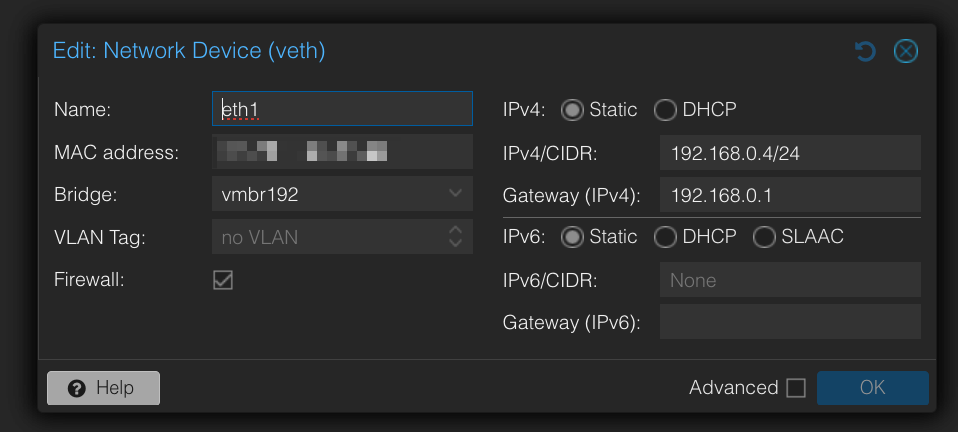

I found a solution.
I added a second Linux Bridge with rerouting IPv4 to IPv6.
All services are online now and nextcloud is working like it is installed with an IPv4 address. Thanks to cloudflares proxied IPv6 I also get IPv4 for my Nextcloud instance from cloudflare, so should be now reachable also from IPv4 only networks.
auto vmbr192
iface vmbr192 inet static
       address 192.168.0.1/24
       bridge-ports none
       bridge-stp off
       bridge-fd 0
       post-up   echo 1 > /proc/sys/net/ipv4/ip_forward
       post-up   iptables -t nat -A POSTROUTING -s '192.168.0.1/24' -o vmbr0 -j MASQUERADE
       post-down iptables -t nat -D POSTROUTING -s '192.168.0.1/24' -o vmbr0 -j MASQUERADE
       post-up   iptables -t raw -I PREROUTING -i fwbr+ -j CT --zone 1
       post-down iptables -t raw -D PREROUTING -i fwbr+ -j CT --zone 1
