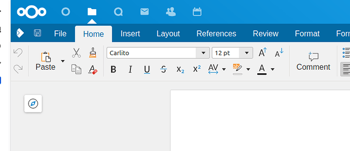

AT ANY POINT , you can check that the demo servers do indeed work from
my version 22 I just installed yesterday, that works out of the box with demo servers (on Ubuntu with Apache and LetsEncrypt SSL)

you didn’t read it all that’s how I can determine collabora demo servers are working, and so can you from the install you did yesterday and sent me screenshots.. please read and understand what I’m saying, I am NOT interested in using built in code, only a stand-alone coolwsd server. The demo-servers, in spite of the warnings, are working, and can be tested that they’re working from your fresh NC instance or my V22 one. We’re testing with the demo servers only (at the first tech guy’s recommendation BTW) so we know we are only focused on the Nextcloud instance with verifiably working demo servers.
