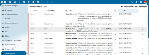

Did you check the nextcloud.log?
In Browser under Administrative settings - Logging:
an error message like this?
Like the cURL 60 issue in richdocuments ? Nope…
I had DbalException related to some dupe key for files (I cleaned trash bins, and it did the trick, at least, it seems for now).
