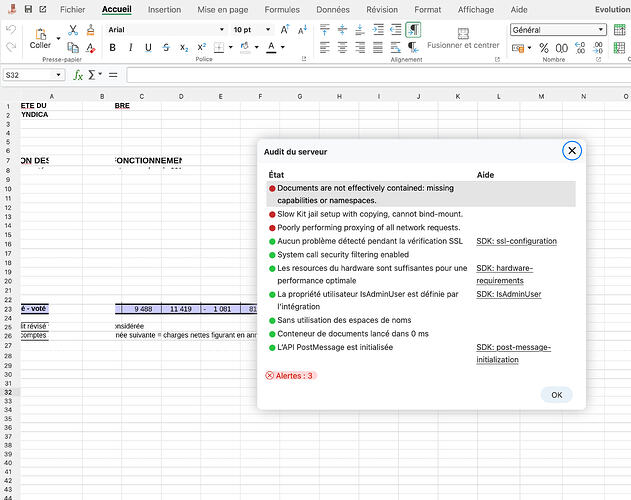

[EN] Hello,
For some time now, I would say about two months, my Office documents (.doc, .xlsx, .odt, etc. -but not .md nor .pdf) that open with the Office suite integrated into Nextcloud are no longer usable: I can’t get a complete display, parts are missing (see included image). In addition, I’m getting errors that I have to find the source of and therefore solutions for.
Do you have any idea what might be happening?
Thank you in advance.

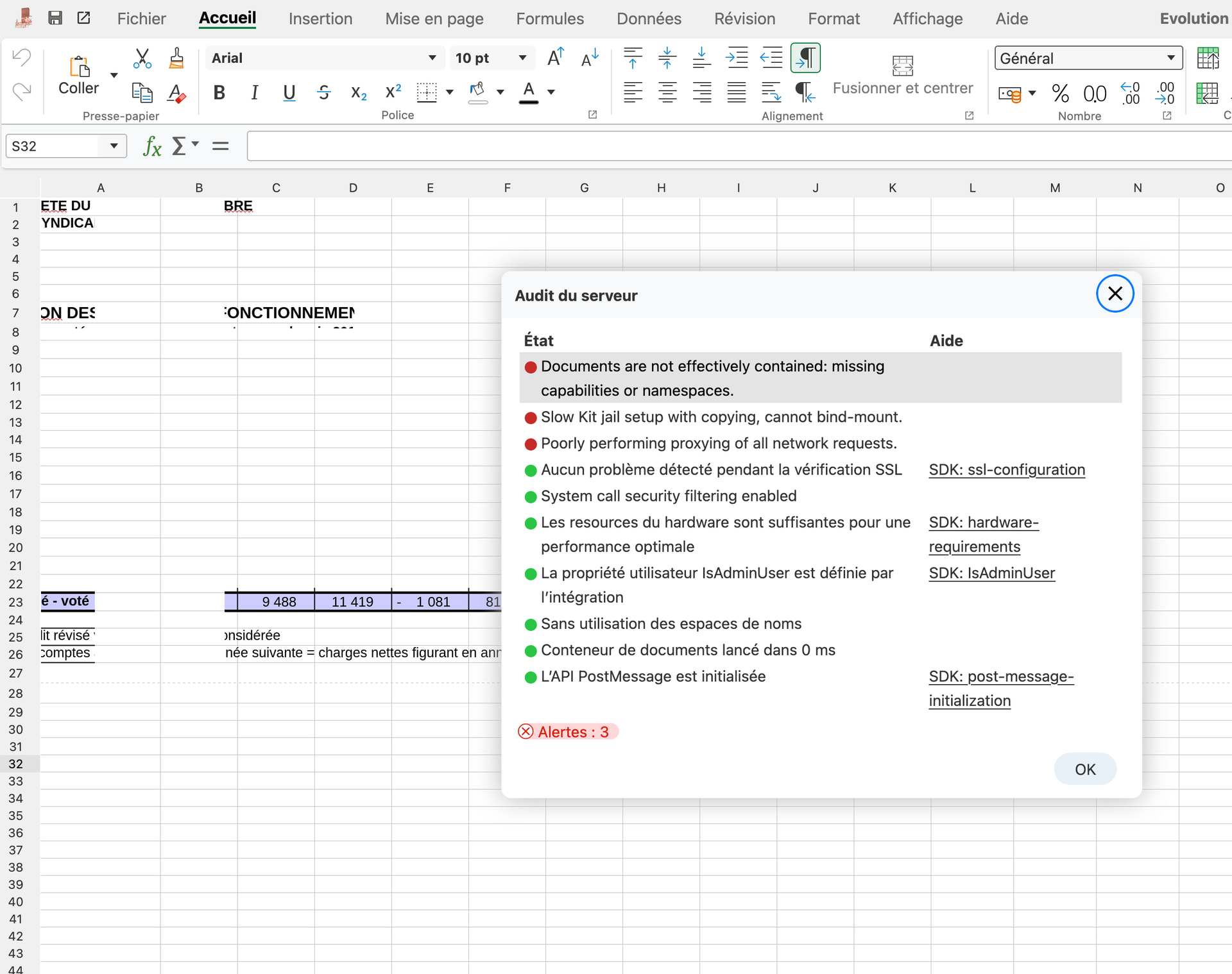

[FR] Bonjour,
Depuis quelques temps, je dirais environ 2 mois, mes documents office (.doc .xlsx .odt … -mais pas les .md ni .pdf) qui s’ouvrent avec l’office intergré a nextcloud ne sont plus utilisables : impossible d’avoir un affichage complet, il manque des morceaux. De plus j’ai des erreurs dont j’ai du mail a trouver l’origine et donc leurs solutions.
Auriez-vous une idée de ce qui se passe ?
Merci d’avance.

The error “Poorly performing proxy of all network requests” is the main reason for your issues. However without seeing the actual setup it is not possible to say exactly what is wrong.
About the other two errors, also see here, how to setup Collabora in a Docker container without getting these errors:
Personally I use Apache to provide the reverse proxy as described here, but NGINX is also possible - maybe you need to change your setup:
And by the way: PHP should be version 8.4. Version 8.2 should not be used any longer. Also see PHP: Supported Versions

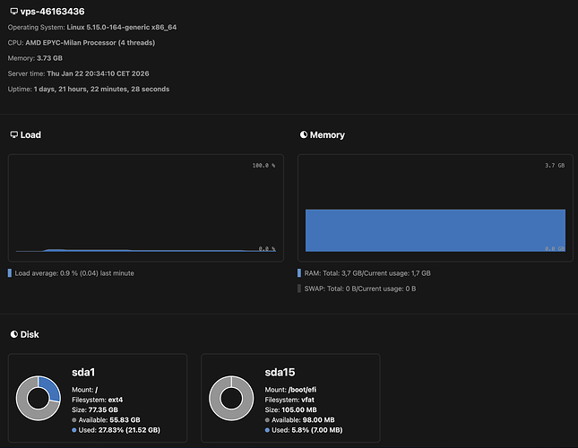

Well “a VPS” is a very generic thing - I don’t know anything about the infrastructure (which other users are on the same VPS host, wich network connectivity is provided and so on.
So you should analyze if there is a bottleneck on the VPS in general (fio to test I/O performance, speedtest-cli to test internet connection speed etc.), check if the CPU cores for that VPS are exclusively allocated or shared with other users (some providers have different categories of virtual servers and overcommit host resources for the cheaper ones).
Also important: it is not a “displaying issue” - the problem is the network connection to the machine which hosts Collabora. Because of this, the UI does not work as expected. Collabora runs more or less completely on the server. The UI is just like a remote desktop connection to the Collabora server process running for the document.

And as you can see, the VPS load is far from high..
Even if the VPS is not under high load - the network connection may still be poor because other users on the same host use that machine heavily.
A VPS is not an exclusive server for you, but a “virtual private server”. This means, there is a big server used to host many of these VPS instances. The cheaper the VPS is, the more likely it is, that the provider overcommits the server - this means, all VPS together have more CPU cores and memory than the real host behind it. For example the real server may have 64 cores and the provider offers 20 VPS on that host, with 4 cores each, which is 80 “virtual” cores.
Virtualization software supports this for use cases, where flexibility is more important than maximum performance. As long as not everyone is using his VPS a lot, that’s not a big problem. But as soon as users start putting load on their VPS, it will affect all others as well.
The other issue may be network performance - the host behind the VPS instances may be connected with only 1 GBit/s. If there are 10 or 20 VPS on that host, they all share this single connection which can result in a very poor performance.
So you should really check the performance of the VPS:
With speedtest-cli you can check the network connection to the public internet (depending on the distrubition you use, you can install this as package like apt install speedtest-cli in Ubuntu).
In addition you find many other benchmark tools at Github: https://github.com/haydenjames/bench-scripts/blob/master/README.md
And so far you did not show your setup of Collabora. How did you install it? What proxy do you use and how exactly is the proxy configured?

Here is the network speedtest :
Hosted by Orange Polska S.A. (Lodz) [1255.50 km]: 6.079 ms
Testing download speed…
Download: 962.44 Mbit/s
Testing upload speed…
Upload: 929.52 Mbit/s
So CPU, RAM & network seem to be working fine and not heavily loaded.

The “Slow Kit jail setup problem” is already fixed (Slow Kit jail setup warning in Docker caused by a documented error · Issue #14087 · CollaboraOnline/online · GitHub) but it may take a while until updated Docker images will be available. Until then you may have to use this workaround: Workaround for “Slow Kit jail setup …” in Collabora | Arno Welzel
@awelzel its just a workaround, but you can actually disable the server audit:
--o:logging.disable_server_audit=true # disable server-audit
that way I’m not seeing the warnings at all… not good for anything except disabling that annoying warning?
Yes, I am aware of this option. Now, I do not recommend it, since this will only hide the warnings, but does not fix the actual problem. Also the warning will only be display to administrators, not regular users which are not in the admin Nextcloud user group. As administrator you should not ignore these warnings - because these also contain notifications about security updates.
The workaround will make sure, that coolmount inside the Docker container will work as expected. The official fix will also mitigate the problem.
