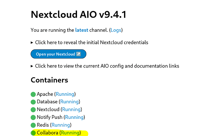

Nextcloud version: Nextcloud AIO v9.4.1
Operating system and version: 6.10.2-arch1-1 (64-bit)
Collabora version: 24.04.6.1
The issue you are facing:
Upon my host’s nightly restart, Nextcloud forgets the appropriate collabora url. Docker-compose down does not do the same thing.

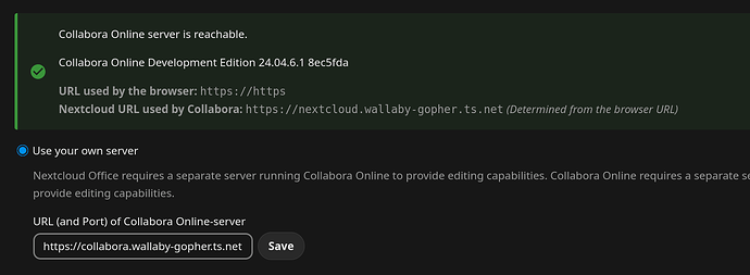

Here’s what it’s supposed to look like (and works when I do it manually):

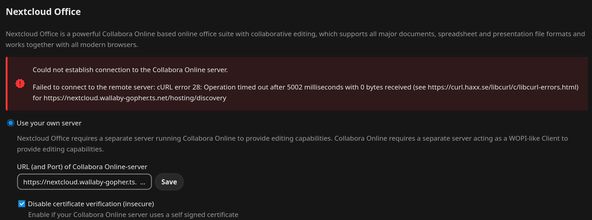

Here’s what it looks like after a host restart:

Yes, I can open and edit documents when I manually change the url to the correct one every day after the restart. It saves the incorrect url so it never connects properly until I change it again.

and after a restart we’re back to nextcloud instead of collabora again

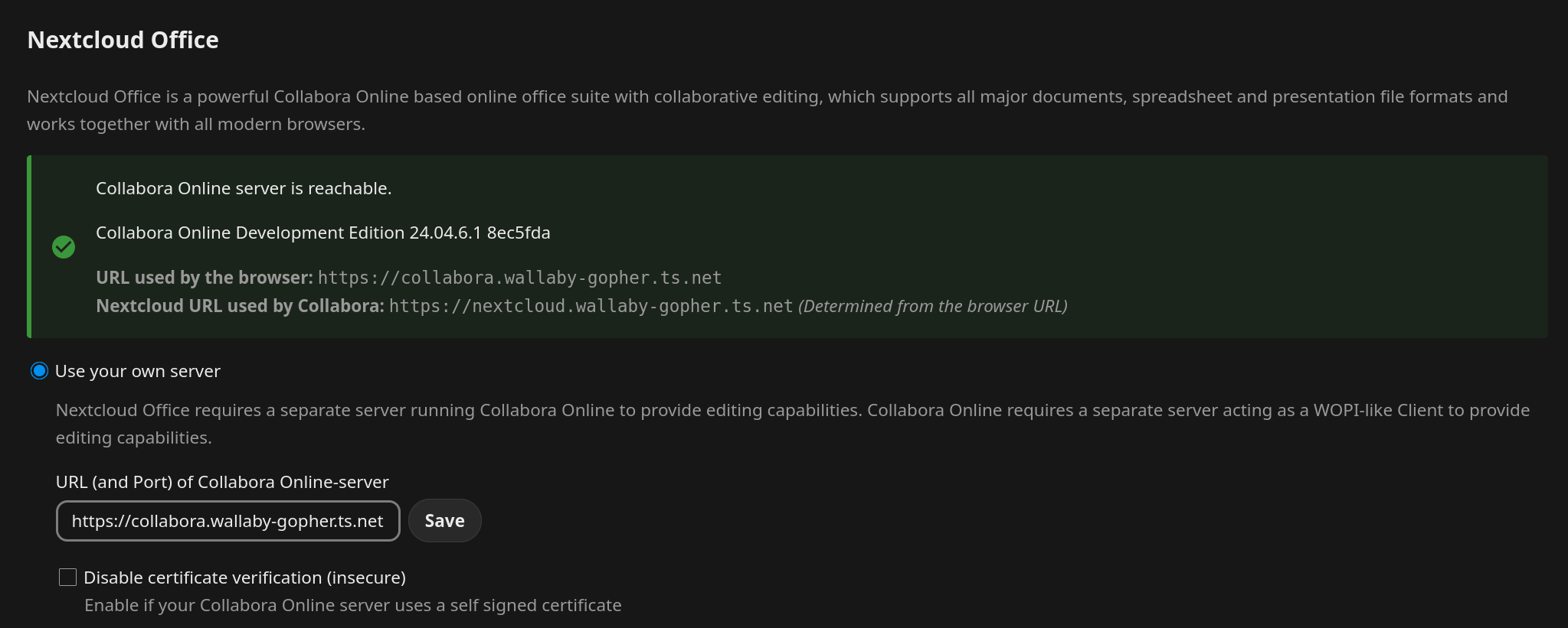

Commenting - server_name=https://collabora.wallaby-gopher.ts.net lets the documents open again, but again, upon restart back to nextcloud.

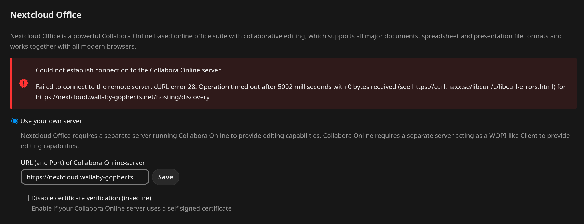

I’m able to open documents with and without disabling certificates when server_name isn’t used.
I notice in the nextcloud log it says collabora is still the public WOPI even though we set it to nextcloud.
Checking configuration
šŸ›ˆ Configured WOPI URL: https://nextcloud.wallaby-gopher.ts.net
šŸ›ˆ Configured public WOPI URL: https://collabora.wallaby-gopher.ts.net
šŸ›ˆ Configured callback URL:
Failed to fetch discovery endpoint from https://nextcloud.wallaby-gopher.ts.net
cURL error 28: Operation timed out after 5002 milliseconds with 0 bytes received (see https://curl.haxx.se/libcurl/c/libcurl-errors.html) for https://nextcloud.wallaby-gopher.ts.net/hosting/discovery
