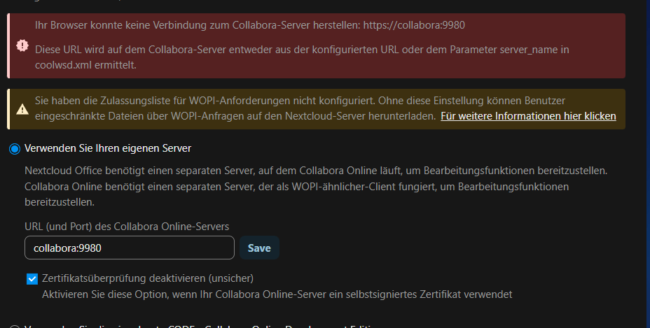

I try to set up Nextcloud with basic services inside Docker (AIO is not working for me).
Nextcloud is already up and running, now I added Collabora. The Container is running and prompts that it is ready to accept connections.

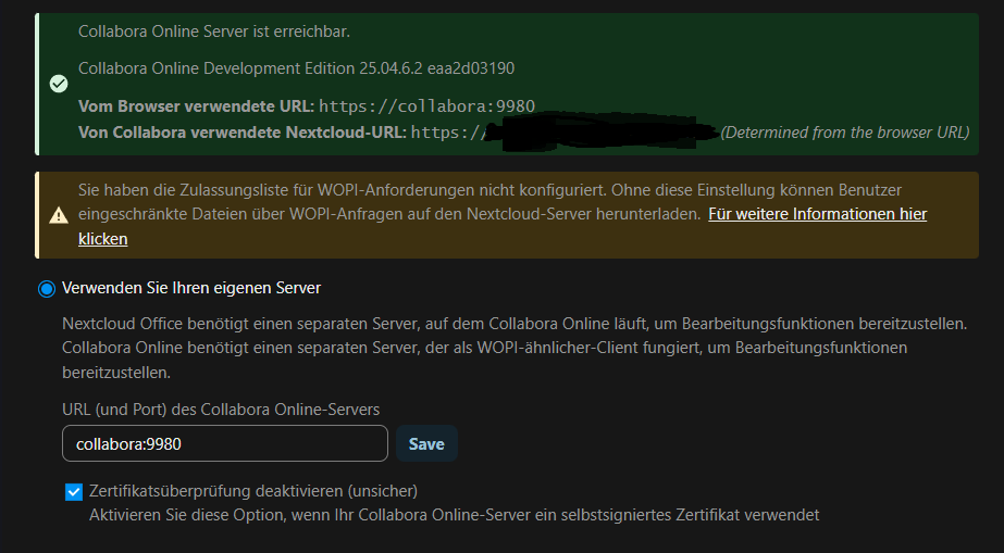

When I try to add the office server in the NC admin settings it first gets a green message, that turns into a red message after a few seconds.
  1. Enter the collabora hostname (collabora container name)
  2. press save
  3. wait
as both containers run in the same docker network, the container is usually accessible via the container name, though I also tried to add the IP of the container and it didn’t work either.
none in the logfile, error message in web interface see screenshot above
see screeshots above
