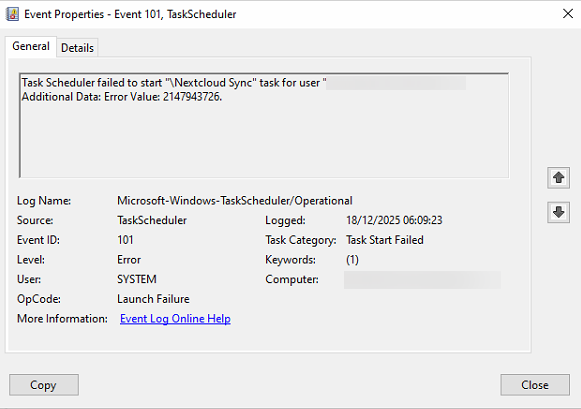

I created the scheduled task as mentioned above but when I run it with the same account who installed it I got an error that the task could not start as scheduled with the following info:
“Additional Data: Error Value: 2147943726.”
After looking up I found that this is mostlikely related to bad password or wrong account. As I anyway wanted to use a service account to avoid problems if admin changes his password I created a service account and used that one. But still the process isn’t launching I still get the error
I would be happy if somebody having experience with this would help me.
