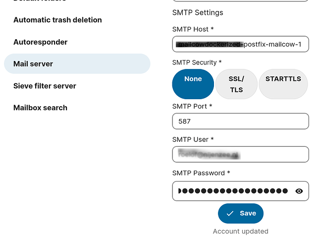

Also, I just saw that you use the php-mail transport 1. Perhaps you could try to remove this setting temporarily and see if that improves the situation. Is there a specific reason for overwriting the transport setting?
This looks a bit like the credentials for SMTP are not correct. Have a look at your account settings of the mail account inside the Mail app and double check port, encryption and enter the password again.
I did notice something strange in the configs from the mailapps, thanks for pointing me in that direction!
But…
Snappy mail is using the external server name on the internal ssl/tls port (4065).
Mail only authenticates using the docker hostname using no security.
If I configure it the same as snappymail it fails to my surprise (they are running on the same docker container I assume or am I wrong assuming that???).
I don’t know where you found I am using PHP-mail (php in the screendump?), I can’t find it in /docker/volumes/nextcloud_aio_nextcloud/_data/config/config.php or am I looking at the wrong place?
As I asked it here before, the screendump was a little older. I allready disabled PHP in the email.

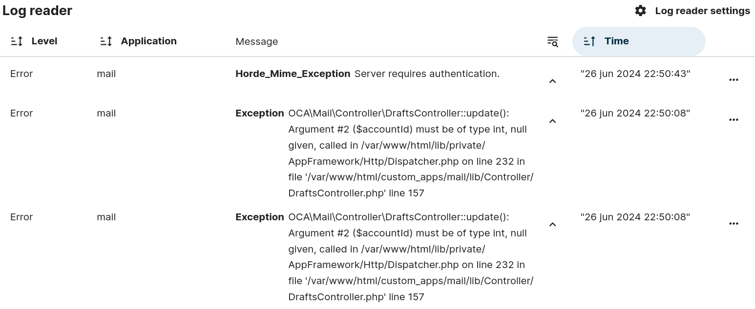

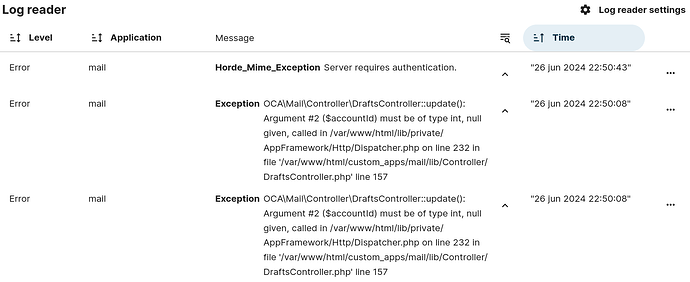

These are the failures when trying to send an email now:
Error mail
Horde_Mime_Exception Server requires authentication.
“26 jun 2024 22:50:43”
Error mail
Exception OCA\Mail\Controller\DraftsController::update(): Argument #2 ($accountId) must be of type int, null given, called in /var/www/html/lib/private/AppFramework/Http/Dispatcher.php on line 232 in file ‘/var/www/html/custom_apps/mail/lib/Controller/DraftsController.php’ line 157
“26 jun 2024 22:50:08”
Error mail

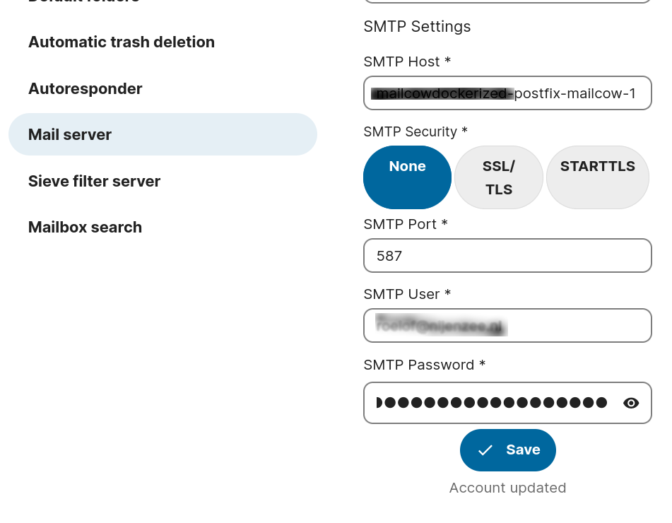

This is also fascinating:
Account updated suggests it works, but not in this case…
[mail] Error: Server requires authentication.
POST /apps/mail/api/outbox/78
from 192.168.0.124 by … at 14 jul 2024 15:57:34
So there is a bug in the mail app. It does not authenticate at all.
It doesn´t matter what you fill in in the user or password, it always passes. Wrong ports or targets get detected but it does not authenticate.
When sending it does check and then it fails (still no reason for that), so one horde taken, a lot to go…
