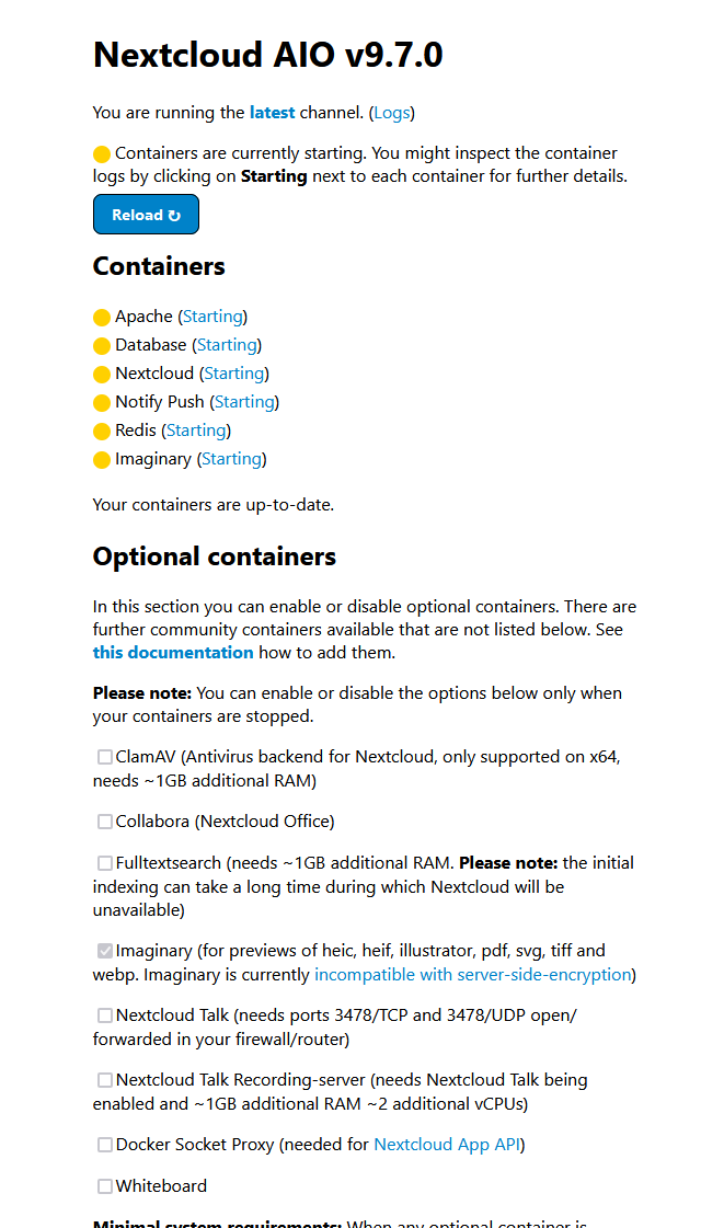

And i can go into the setup page, write down the passphrases and get to the start container screen. But once i start them, “nextcloud-aio-nextcloud” takes forever to start. I let it run for like 5+ hours yesterday and its still not finished. And this obivously feels like somethings very wrong.
All containers just say “(Starting)” but theyre all waiting for the nextcloud container to start.

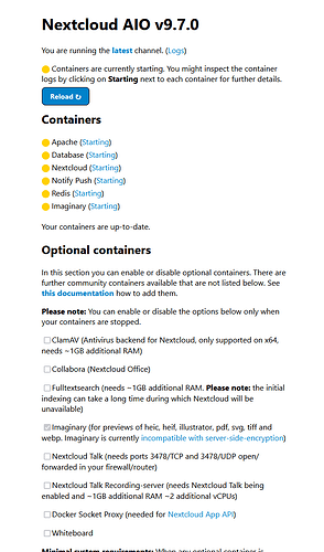

Can you post a screemshot of what you are seeing in the aio interface currently?
And youre so right. I 100% missed that point in the documentation and it got rid of that warning right away

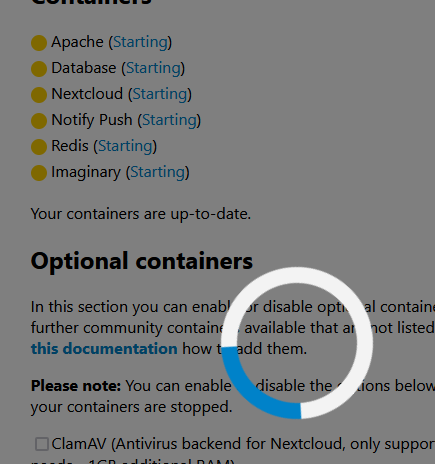

What happens if you click the reload button?
I just get the loading screen for a solid 20 ish seconds and then nothing happens. Same as before
Interesting! So it looks like the mastercontainer cannot reach the other containers. Can you post the output of sudo docker info here?
